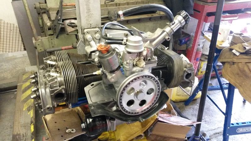

Engine now back in as well, fettling take an age, but well worth it.
HiPAC access panels make fitting the carbs a synch...
http://i77.photobucket.com/albums/j6...ps725ecff8.jpg

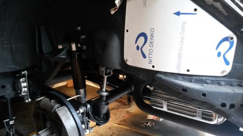

Hard brake lines made up, ready for flaring. Flexis are in place, checked the caliper/flexi when it's being steered and it'll do I think:
http://i77.photobucket.com/albums/j6...ps5af9444e.jpg
http://i77.photobucket.com/albums/j6...pse5c7619a.jpg
Refitted the Zbar cups the correct way around and replaced the springplate mounting bolts, looks much tougher under there now :grin:
http://i77.photobucket.com/albums/j6...ps53a7e499.jpg
Gonna check the Z bar tolerance with the axle cups as I've installed a 32mm spacer to lower the bung which should make contact sooner than stock.....we'll see how it works out?

Good day today...got more stuff done>
Hardlines, 'zorst, rocker covers, HiPacs and sparkplug holder on firewall behind right carb.
http://i77.photobucket.com/albums/j6...psa2cebb80.jpg
Engine bits coming along as well, filter change, oil drained, belt on....just need to sort dynamo to alternator wiring.
http://i77.photobucket.com/albums/j6...ps8febaa2f.jpg

Liking the view under the wing...
http://i77.photobucket.com/albums/j6...ps540e0ec8.jpg
'zorst on again...
http://i77.photobucket.com/albums/j6...ps547160d3.jpg
Oh yeah, it's a bit shinier now I've given it a quick polish
Hope to fire it up this week.

Update:
I dug the bug out after a UK winter to find it popping and backfiring a bit too much for my linking, so a quick look see and it was determined the valves on the engine leftside were not sealing properly along with an inlet gasket failure as well.
So, reluctantly dropped out the engine and stripped off the l/s head. The #4 exhaust valve was not sealing, but a slightly bigger problem was apparent......both /s barrels were quite badly corroded. This has got to be due to the engine spending a long time laid up, with no oil down the bores, leading to condensation causing the barrel corrosion.
http://i77.photobucket.com/albums/j6...psy88gpsyn.jpg
So, it needed two new barrels at least. Now, fortunately, my mate Scotty had a few spare b&ps in the correct size (1641cc) so they were honed and pressed into service. They were nearly new, less than 2000miles, so were in very good condition. The r/s barrels were like new so no problem there.
http://i77.photobucket.com/albums/j6...ps4bioef8k.jpg
It was a learning curve for me as I'd never stripped a type1 engine before, so all good. Once back together, I was pleased to have had the experience.
So it's all back in and running sweetly, balanced the twin 34s yesterday and I'm pleased it's running so well 'touch wood'.
