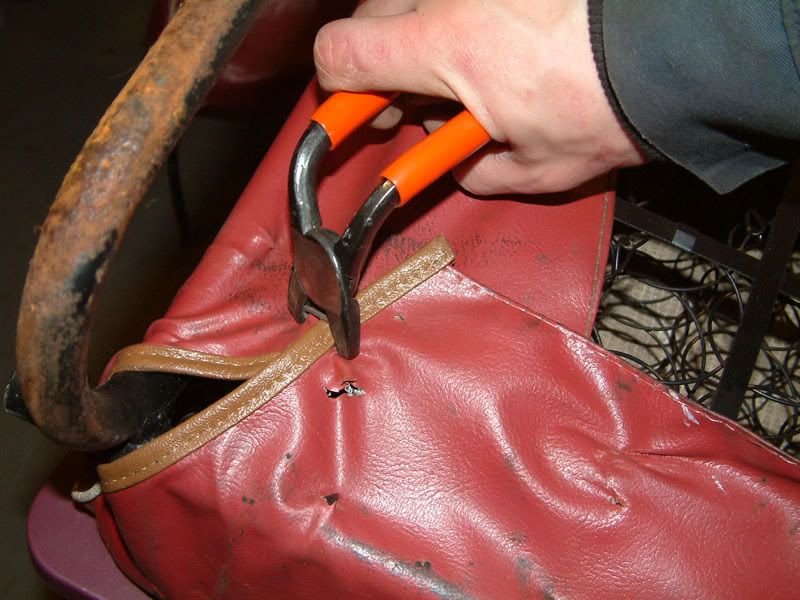

Repeat for the last side And you are just about done. On my seat I
fastened the loose ends of the flaps to the seat frame with hogrings. This
is a hog ring and hog ring pliers:
And the finished bottom. It doesn't have to be pretty under there, as long
as nothing is hanging down no one ever sees this.
