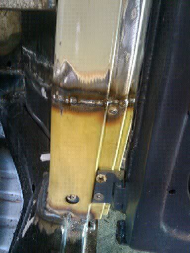

Pillar cuts as they were uncovered:
Broke this joint free with a nail file
Now all safely welded:

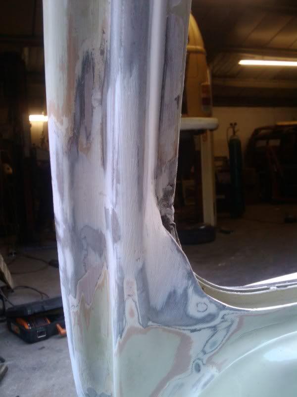

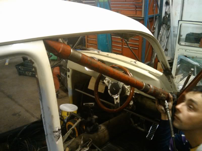

The last round of work has moved into the filling n rubbing stage as the bodywork receives attention:
Oh yeah, remember that bent B pillar? A gentle PortaPower session soon sorted it
Now I have a decent enough shutline:
and a reasonably straight B pillar, (filler required)
