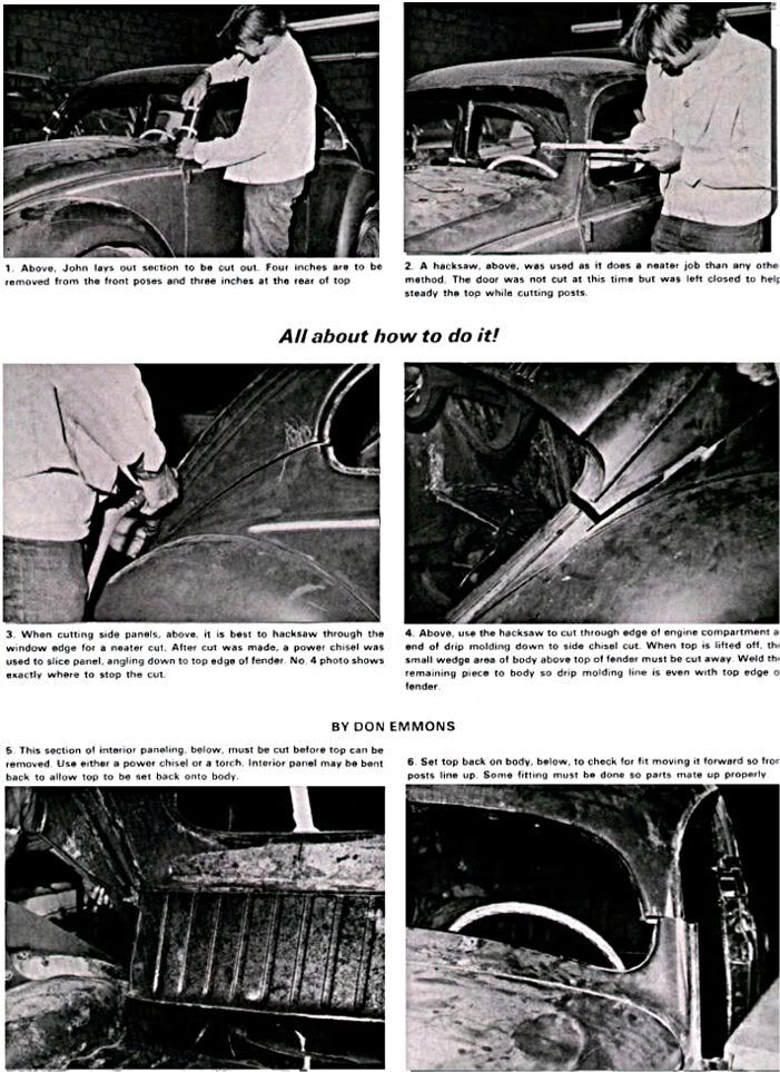

Here are three articles on how to chop a bug roof that I have collected...
First article:
(according to the photo titles, there should be a page 7 here???)

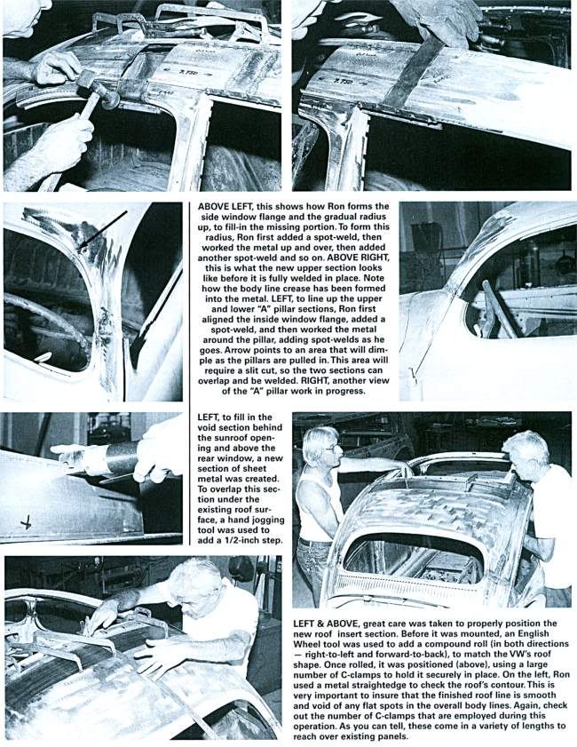

Article number 2:
