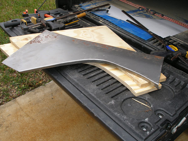

I decided to finish cutting the front end away so that I can start working on extending the inner wells
Marked out where I wanted to cut on the other side so that they would match up.

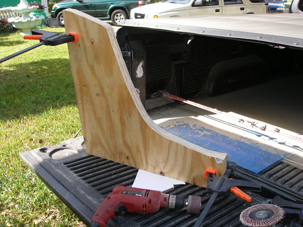

Now that both sides are cut away I can start to make the new panels for the inner fender well.

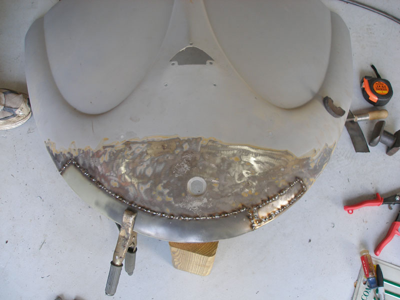

Again more little things that needed to be fixed, the front of the hood needed some welding and filling.

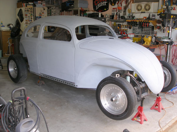

So I started to take off the drivers side rear tire since that was the only tire that I had not taken off since I bought this car and wouldn't you know it took me about two hours to take it off (rusted up seized bolts) but eventually I was able to get them loose so I decided to clean this side as well.
Also cleaned the adapter and primed the inner well.
The inside of the rims were also full of caked on brake dust and needed to be cleaned.
Tires back on and lowered to the ground, starting to look a lot better.
A view from the rear.
Hopefully I will get a little more work done on it tomorrow.

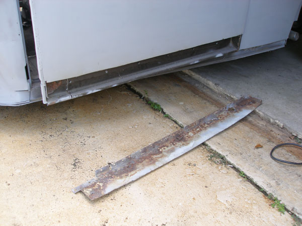

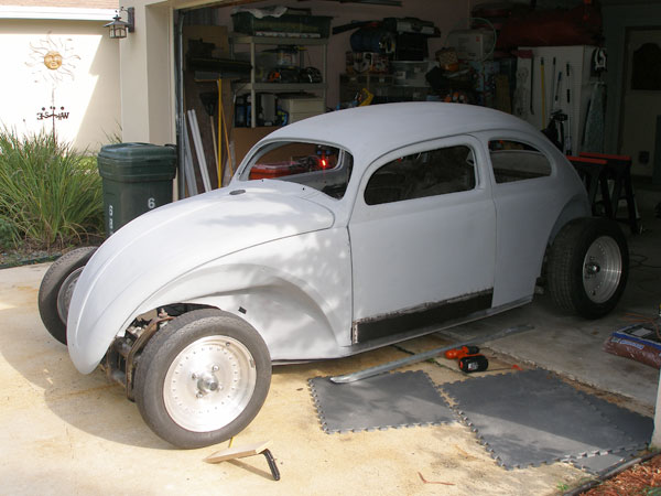

Well, we finally finished putting the bottom of the drivers side door on and now it is official, the entire bottom of the body is new metal, no more chasing rust, at least on the bottom of the body.
We started by marking off the area on the door that we wanted to cut off.
As you can see the entire bottom was pitted and riddled with holes.
Next it was on to replacing metal, we started with the inner structure of the door frame.
Then we went to work on the door skin.
Test fitting it for the hundredth time to make sure that the body lines match up and the contour of the door was still intact.

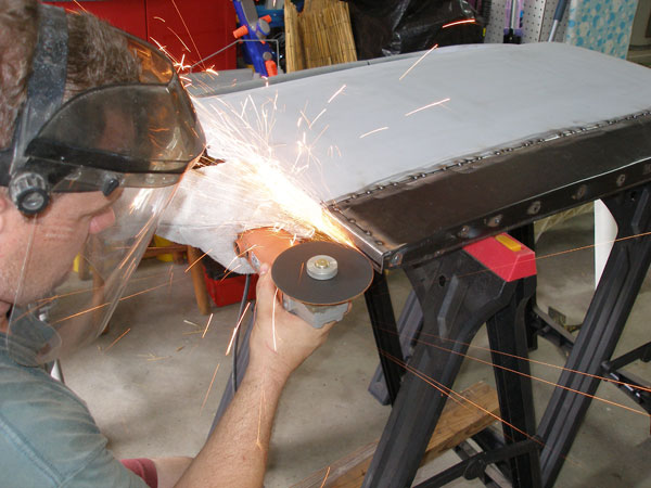

Welding the seams, making sure not to oil can it when we welded the large area
Adding metal to cover the hinge area.
Trimming it to fit.
The door finally back on the car with a bottom.

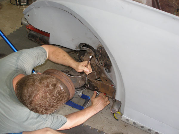

First we had to remove the trailing arms that were on the car.
Since they had been on there for over 35 years they were a little stubborn.
With everything broken loose we could begin to remove the training arms.
You can see the test trailing arm (with the disk brakes) next to the one we just took off.

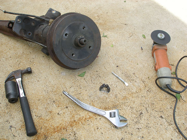

We began by trying to remove the nut that holds the axle together and let's just say that it did not want to come off, so we decided that no matter what, it was coming off, well after we bent and twisted several wrenches and broke a pile of tools we said fuck it and cut the fucking bolt off.
Go ahead fuck with me and I'll cut your ass...
OK, Sorry I had to vent, so back to work, we took both trailing arms and began to cut them up so that we could swap them from side to side.

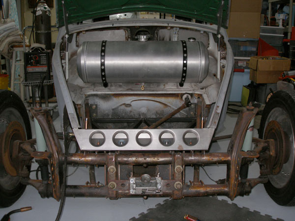

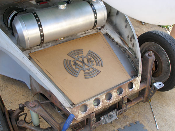

Made the final mounts for the gas tank so that it sits off the body far enough for the shut-off valve to open and close.
Then we proceded to make the brackets for the headlights.
Again as always we wanted a little something different.
Once they are all welded in they will be ground down and look like they are part of the beam.
Some shots with the headlights mounted to them.

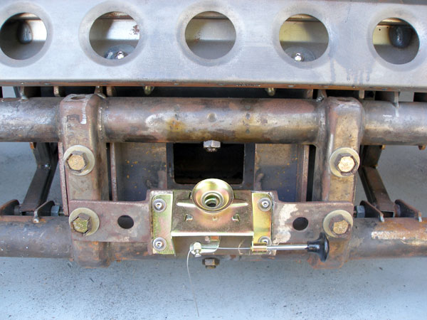

So before we start to brace the front beam we had to make sure that we have the right amount of caster in the beam, because once we weld this bracing system together the front end can not be changed.
We start by setting the car up on the plates and getting everything zeroed in.
Then we set the caster / camber level and begin to make adjustments.
Now that we have the right amount of caster in the beam that we want we can now begin to brace the front end.
Before we start to go over the front end bracing lets keep in mind that the Evil Metal Genius is use to building frames for things that go over 200 mph so he tends to over engineer everything that he does when he builds cars. That being said we have built this front end so that the force of the beam is supported throughout the car and not the frame-head were you only have four bolts holding the beam extender and the front end together.
We started by making a new bracket system for the front beam.
Then we begin to cut the 1" square tube (1/8" wall) so that we can make the frame.
Setting up the rear brace that will be attached to the firewall.
Welding the plate to the upright.
Then we begin to weld the frame extenders to the new brackets.
Now we can begin to put the lattice work into the frame brace.
One side of the new beam extender brace is welded together so that we can bolt it back into the frame.
Here is the new upper beam bracket
Here is the new lower beam bracket.
Here is one side bolted back into the front end as you can see it is a little overkill but this front end is not going anywhere.
Here you can see how it is bolted to the firewall, the bottom is threaded so that we can run a bolt up to support the frame to the pan, after we finish the other side we will X-Brace it across the back wall and then also tie it off into the frame-head.
Now I need to finish the lattice work on the other side.

We finally came up with a way to incorporate the cool plate for the front end using the original VW latching system, so we started to weld on a backing plate to re-enforce the latching pin.
The backing plate is tacked in to place on the plate.
Then we started to Cleco the plate system on the hood.
Welding the plate into place on the hood.
The plate looks pretty good and re-enforces the front end of the hood, again a lot of work for something that will probably never be seen or noticed, but we know it's there.
Now we can nutsert the latching pin into place.
The hood is set with the latching pin in place.
Now we focused our attention to the bracket for the latch. I'm not going to go in to detail about the first bracket we made but lets just say we spent two days making it and about 5 minutes to cut it apart and make the bracket we should have made to begin with, that's what happens building Kustom Cars. So we took all of the pieces of the original bracket and welded together 5 pieces of metal to make the Bracket From Hell.
Here is the bracket all welded together.
Here it is with the welds all ground down.
The original latch set inside the bracket.
Here it is bolted to the beam.
You can see the angle set into the bracket so that the pin latched in the receiver.
There is a lot going on inside the front end of this car...

Back to work on the front-end. We decided that the only way to get the panels to look the way we wanted them to was to make a buck and to form the panels by hand. So since I am the "Wood Butcher" it was up to me to make the wood bucks for the panels.
Then it was time to cut the template out so that we could form the panel.
The panel was cut over-sized so that we could work on it and then trim it down.
Then the panel was placed in the buck to be formed.
Here is where the "Evil Metal Genius" lives up to his name. Hand forming the metal to the shape of the buck.
The panel is now formed with a nice lip around the edge to stiffen up the structure and to give a nice edge around the lip so that we can pick up the front end without cutting our fingers off.
Now it's time for a test fit.
Some minor tweaks with the shrinker to pull the front end in towards the nose.
Trimmed down and Cleco to the car to see how it looks.
Next we begin to work on the front brace that ties the front end to the frame of the car. As always we start with a cardboard template to get the look that we want.
This is going to be a trick little brace with a re-enforced inner structure to tie the body to the frame.

After laying it out on the car to see if we liked it, it was time to make a decision because once we make the first cut there is no turning back.
We marked out the grill so that we can cut it out.
Then we proceeded to cut the bars off.
Then we had a pile of VW tooth picks.
Then we made the final cuts before welding the piece in.
Then we tacked the piece into place.
A little grinding and lets have a look.
That's 10 lbs. of sexy right there.
Now we need to finish welding it in and grinding it down. It gives the back end a different look (like a battle bug) but I like the way it came out.

The vent section has been welded in place and now needs to be ground down.
After everything was ground down I spray bombed some primer on it to have a look and save it from rust until we begin the mud work.
Here is a shot from the side so you can see the profile of the holes it gives the back end some character.
