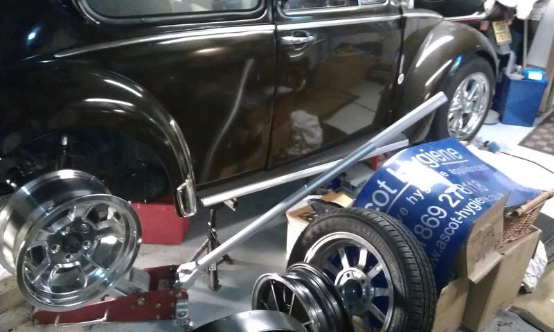

Well, has it really been 2 years !!!! A quick update you might be interested in.
After a very good Summer running around in the but a lot, I dropped the engine out to clean it up as it had become very grubby.
Since then, I was reluctant to hang it on a very dirty gearbox and back end. So, after missing out this summer, I thought I'd do it how I wanted it.
Here's the plan:
I wanted to run alloys not very many Vdubbers have in the UK, ie Halibrands on the rear and Rocket Launchers on the front as I like the gasser style but lowered in teh vdub stylee....my hotrod influences coming through me think!
To accommodate the 7x15 rears I need early short shafts with late brakes allowing a 1.25" extra clearance with stock wings. So a re-drilled Ford 4.5"x5 PCD drum, hanging on adjustable springplates and a few shiny bits.
Up front I want 4.5"x15 cast spoke alloys on my drilled discs and dropped spindles and Protech alloy billet shockers as I'm trying to find a good ride quality with a narrowed n lowered beam front end - hopefully I'll achieve what I want.
Here's a few images of what I've been up to:
These are the wheels and tuck I want
Rear wheels
Got these exported to the UK from a stateside dealer.
Couldn't help mocking it all up
Currently getting the disc/hubs redrilled as well as brake drums. Early shortshafts will allow more tuckage for the wider wheels and adjustable to get the ride height spot on. Front beam will ahev to be narrowed 4" to get the front wheels where I want them under the wings (had the wing edges rolled which gained me 11mm each side). Dropped spindles will allow a softer ride.
Beam will be my own brand BEAM!==!TECH custom made with early shock towers and powdered.
The trouble I'm going to just to roll the wheels I want
I'm cleaning and painting everything and sorting the body/chassis so it's clean n tidy. This bug will not be a trailer queen showboat, but a slamdoor driver.
Thanks for looking, hope you like? I'll be on here more often....promise
