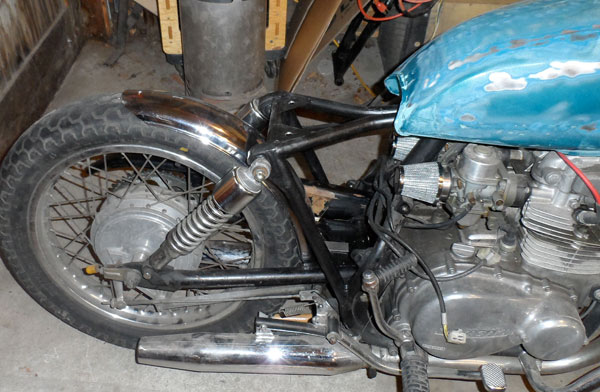

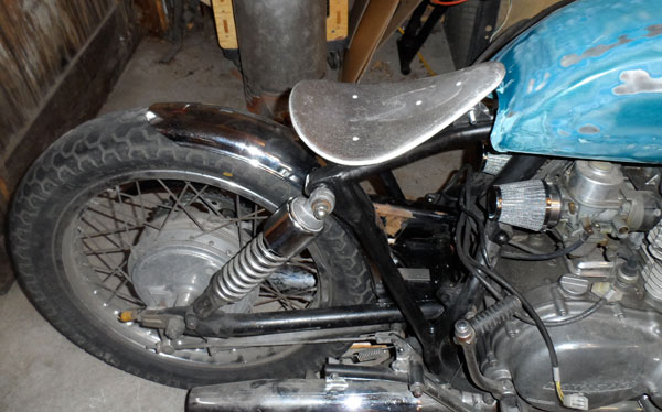

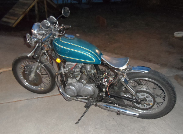

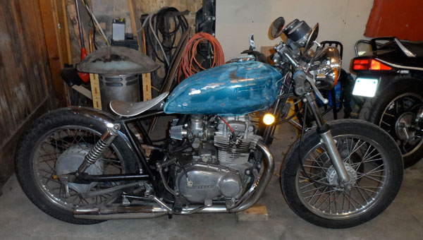

So I have had my KZ400 for a few years now and have really enjoyed riding it. However, when I bought the bike I was looking for a bike to do an old school stripped down bobber style bike. Up til now, I haven't made the time or had the heart to tear into the KZ. That all change today!
I got out of work a little early and it was our first 70 degree day. I went out to the garage with every intention of working on the Sled, by the KZ caught my eye. I thought about going for a ride, but then thought...what would it look like if I just pulled the front fender...gotta start somewhere.
This is what I started with...
By the time I stopped for dinner, this is where I was at...
Pulled the luggage rack, the front fender, the rear fender, the seat, the air cleaner box, the battery and box, the rear turn signals, and the tail light.
I also started cutting up the bent extra frame that I have and cleaned up several of the tubes that I will use to modify the frame. I thought about going hardtail, but decided to keep it a little simpler and keep the shocks. I am just going to relocate the upper shock mount to lower the rear of the bike.
I might have to go to a little stiffer spring on the shock...or maybe up the pre-load because of the change in shock angle. Will just have to see how it feels after making the change.

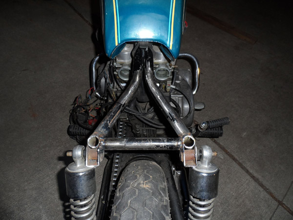

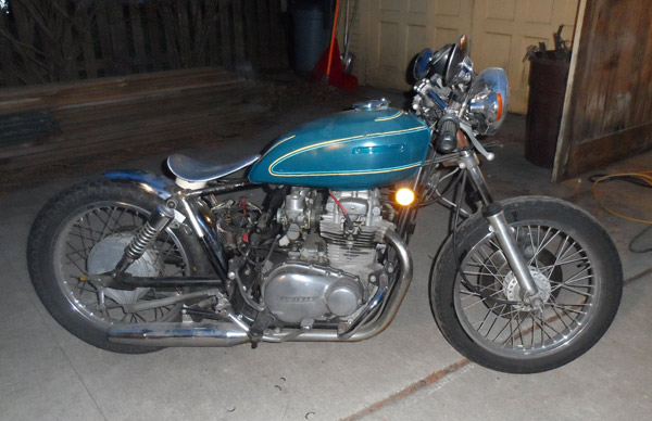

Making progress on the bobber conversion of my KZ400.
I got the frame modifications fully welded and painted.
I also got the seat mounting figured out and mostly fabricated. Just need to weld the front mount to the frame and fab some rubber isolators for the rear mounts.
I am very happy with the results so far.
Still need to get the rear fender mounting figured, modify and mount the battery box, figure out the wiring and mount the taillights, and fabricate the side covers. And of course paint it all.
Old April 27th, 2014, 07:00 PM   #2790
Your bike just screams HOT ROD. I'm surprised you didn't go with a small rear fender.
Old April 27th, 2014, 07:33 PM   #2791
THanks. I am using the original front fender as the rear so it is pretty small. I might shorten it up just a bit more, but not much. I am going to mount the taillights to it also.
