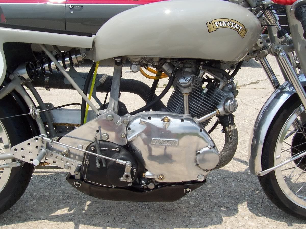

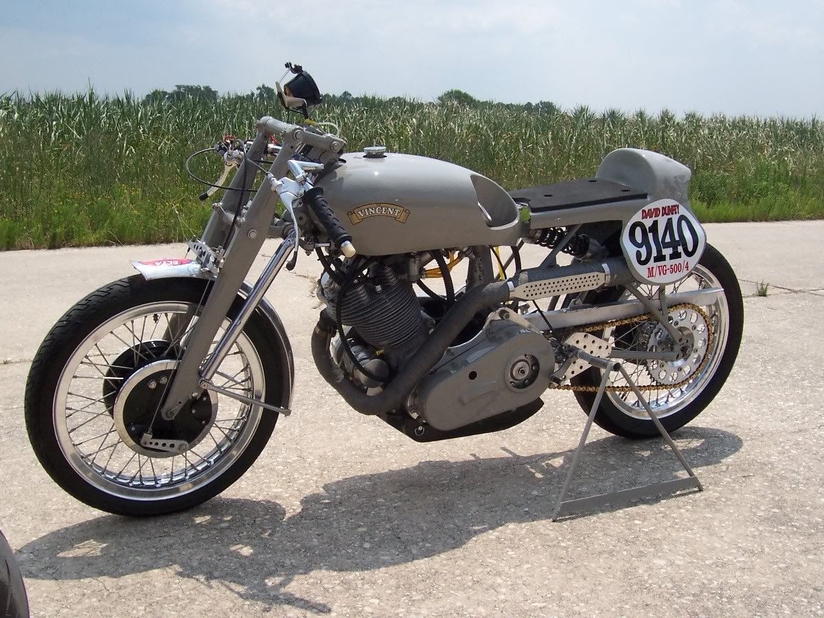

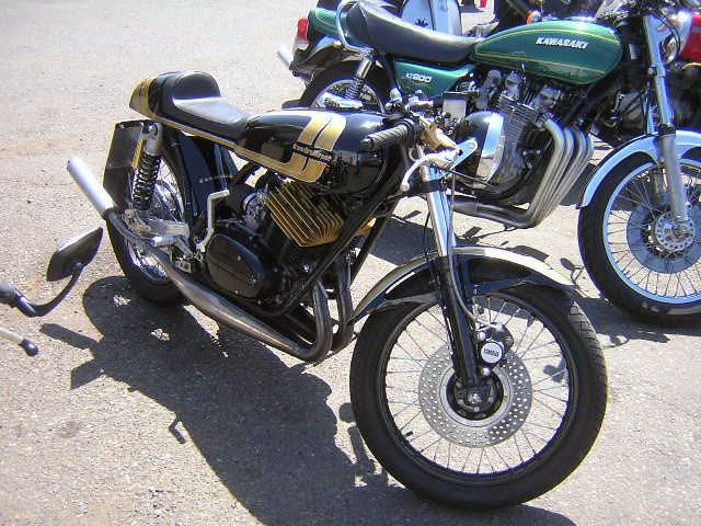

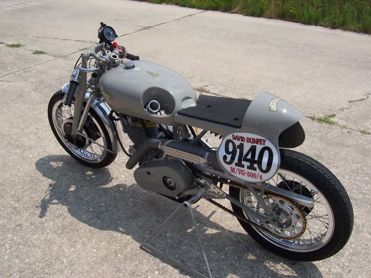

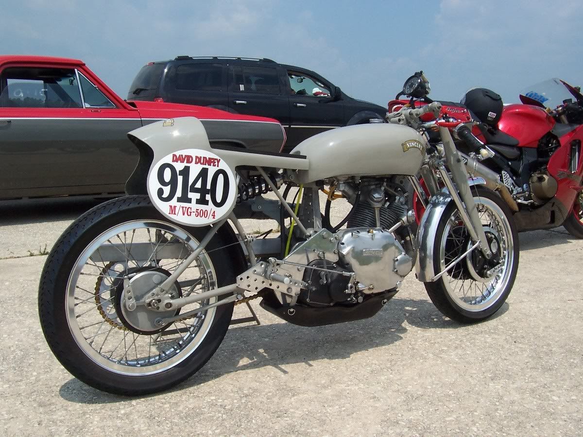

At the ECTA meet today:
I'm in love with this bike!!!
And it looks like it will almost love you back.
Old June 28th, 2009, 08:12 AM   #1111
No joking, it lookslike that would have sucked air right off of the rider'stomach and thigh. I wonder if the rider's position would have created a high pressure area there, increasing intake velocity.
Old June 28th, 2009, 08:27 AM   #1112
Here's a video of it leaving the start line.
I don't remember what he ran.
click to play:
Old June 29th, 2009, 11:45 AM   #1113

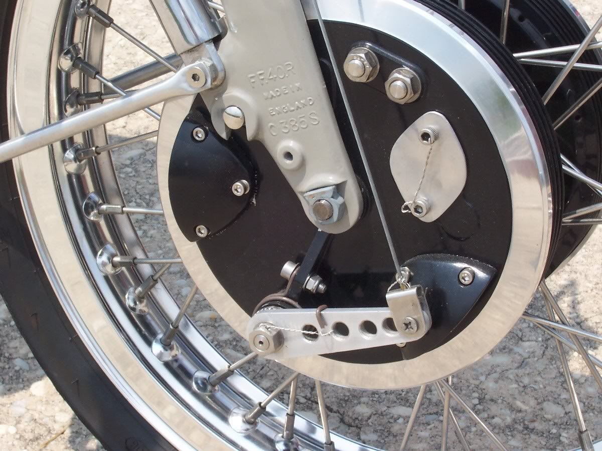

Bad ass bike. Looks like a 4LS front brake. probably not stock, probably cost him a fortune. The right side brake is actuated by a center-pivoting arm, which I've never seen done before. Usually just with a 2-1 cable or twin cables.
Also the rear brake is cable actuated, not by a solid rod. Great ideas for my Royal Enfield cafe project...

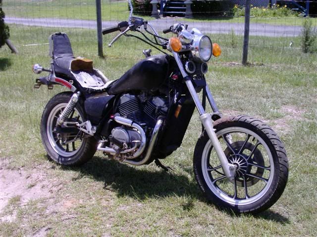

Anyone know if the honda 500 shadow is the same wiring as a 750 ?
Hubby has searched for the last 2 weeks online and found several wiring diagrams for other hondas, but nothing for an 85 honda 500 shadow.
About the only thing left besides some wires , paint the gas tank, is build the seat and it'll be on the rd.
Any ideas?

Im sure they will be at least similuar... You may also try looking at the 500 Saber What wireing info do you need?
Old July 5th, 2009, 02:45 PM   #1116
He's put the controls from another 74 honda on it, has the diagram for that. So he's just needing to know the color codes on the 500 so he can hook them together.

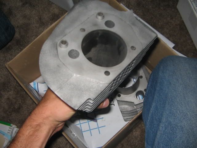

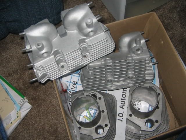

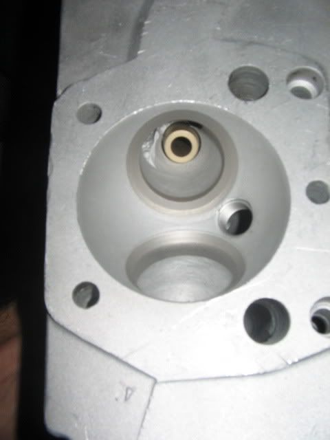

I have a small update on my Royal Enfield project..
First off, I got my heads and cylinders back from a local engine shop after a good bead blasting and hot tanking
The heads need to be milled a bit to raise the compression, along with a good porting. After that, an exhaust valve guide needs to be replaced, then on to re-assembly. I'm aiming on getting the cylinders over to the machinist for re-boring sometime this week, then several coats of hi-temp gloss black.
Here's a lucky buy on ebay. Set of aluminum triple trees, seller claimed to be made by Ceriani. All the hardware is metric, so it's european...
So far I'm under budget with this build.

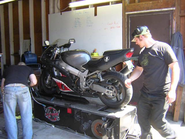

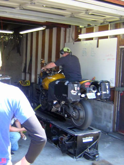

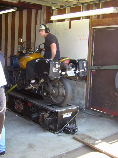

Went down to Seattle yesterday to a benefit dyno day for a local racer that crashed a while back. lots of vintage style bikes and a bit of newer muscle as well. My ZX7 pulled 94 hp at the wheel, my friend Eric's Triumph Tiger 1050 pulled 104 hp and and my friend Rebecca's DRZ400 pulled a whopping 28 Hp.
Pics

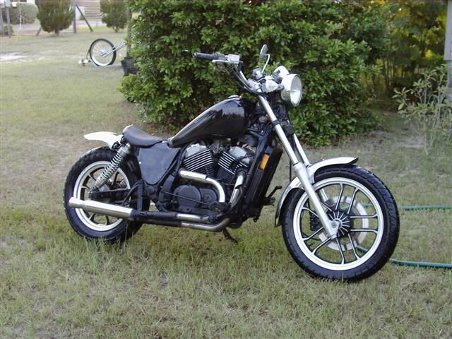

before 6/14
after 7/20
Ok Tim, this is will have to do~
he dwarf;s it as is
now you see why he redesigned the other one so long?

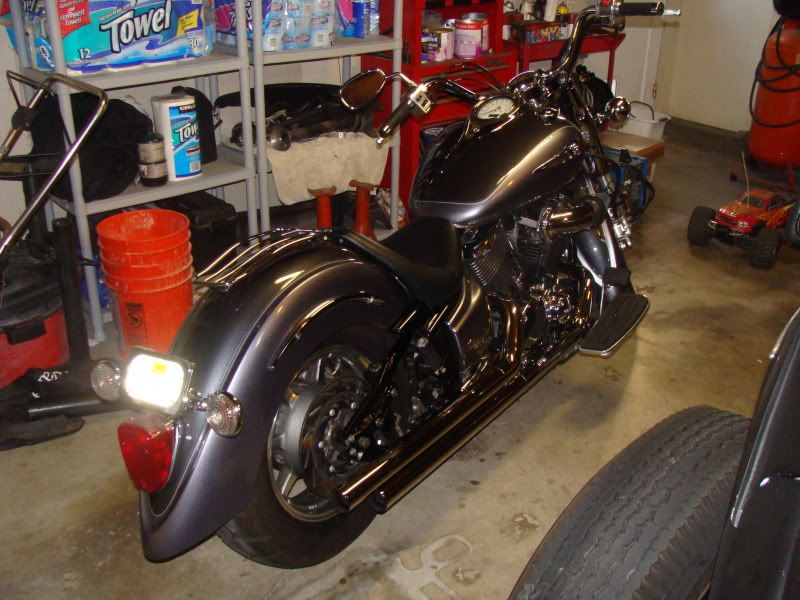

Well I been meaning to take pics of my bike n throw em up here for a while... i'm just lazy..... anywho.....
its a 2006 yamaha v-star 1100, lowered 2 inches in back, pipes air cleaner, jets seat, license plate lay down kit.... not much but i like it...
Plans are braided lines, new mirrors, white walls and a set of cruiser bars.....
