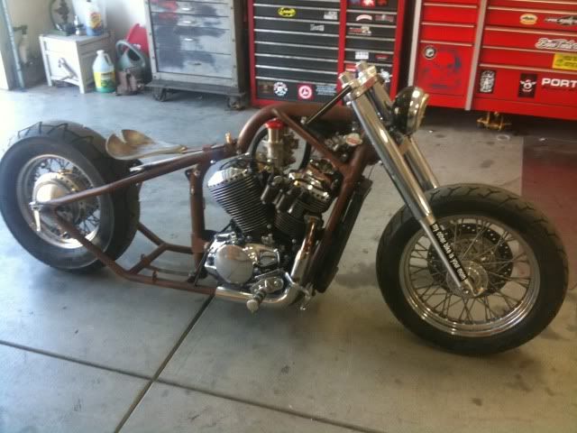

I've seen Weber / Dellorto manifolds for CB750's before. One guy was running a single 40...maybe 44 Dellorto. So much bad ass. I have a side draft 40 Dellorto that is set up for a turbo, but I threw the idea of putting it on my bike. Oh man...
What began as a stock Honda VT750...

That VT 750 looks really nice.like a lot of thought went into the frame. Is that a Weberator?
