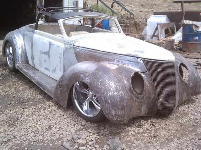

Posts: 661
At home finally. Very exciting!!
...it goes lower!
