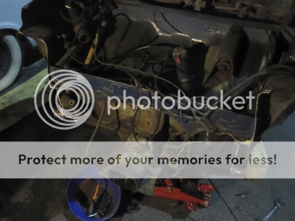

Let me preface, this with my car is my daily driver when i do things i get them functioning and get back on the road and worry about the cosmetics later.

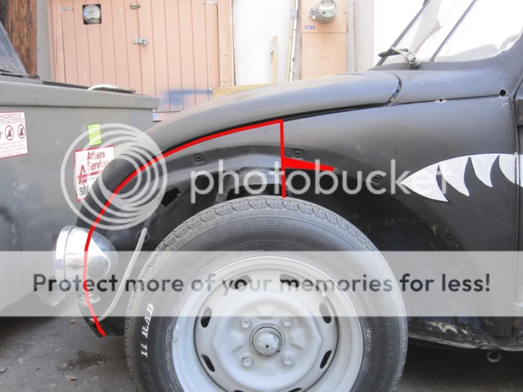

This is the location of my side cuts...but first I'm going to cut out the spare tire recess and remove all of the suspension and steering box....
Cutting out the tire well makes getting to things alot easier....maybe some extra work but makes other things alot easier further into the conversion.

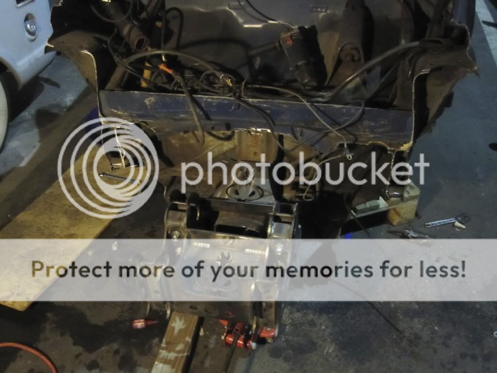

Of course before you get to cutting, remove the tank and all suspension and the steering box (which is easy to get to with out the spare tire well) .
Once everything is cut and gone, you can look down through where the spare tire was and see every thing. Now measure from the brake master cylinder mounts forward to the front end 11 and 3/4 inches scribe a line and take a deep breath and cut through the frame head. After that yank forward and you'll now be looking at this .
Make sure you have the 4 bolts on either side of the firewall out and ready for the adapter.
Me personally, i assembled everything but the beam to the adapter and thin lifted it up (its not that heavy) and slid it over what was left of the frame head .
The little triangular frame head brace as i found would prolly be easier to instal after everything was buttoned down but i was this far and ran with it.
Once slid on, start the bolt on the underside of the adapter at the firewall, and slide the bolts for the old trailing arms through the spaces in the adapter and also start the bolts for the framehead brace.
Get them good and tight but not fully tightened so that if you have to shimmy anything around, you'll have a bit of motion.
Once sure you have it all in place, you will find two holes in the adapter base under the snout of the frame head, bust out a drill and drill into the snout and slide in the little steel spacers and then put the bolts through and crank them down...
Now grab yer beam and bolt it on it takes some rocking to get it in place.
Tighten down the bolts slap on the tires and lower the car...and grab yourself a nice adult beverage.....
