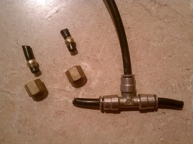

Ok...where do I get these air line parts? In order to move things around, I needed to remove a few lines from the switches to the tank. Couldn't figure out how to pull them apart, so I cut them. They are 1/4" air lines. The air lines say they are 1/4" O.D. air brake lines. The little brass pieces looked crimped.
No idea how the T-fittings fit together so I guess I'm going to need at least 3 more of them and about a half dozen or so of the brass crimpy thingys. I suppose those will require a special crimping tool?
Will any auto parts store carry these things?

Next time that happens push the collar in towards the fitting and hold it in while pulling the airline out.

Its been a while since I did air lines, but as I remember the sleeves were self crimping when you tightened the fittings. You might check the internet for a few of the airride outfits to locate replacement bits.
If you have a truck parts store (as in semi) those are as common as fleas on a dogs ass and alot cheaper than going through the air ride or bagger guys.
If you push the collar toward the fitting and pull out on the line it SHOULD pop right out.
A- you need to relieve all the pressure or it wont release
B- somtimes you have to twist the line in the fitting to loosen it first, kind of like trying to unscrew it then push the collar in and pull.
C- if it's leaking around a quick connect pop the line out trim a 1/2 inch off with a razor and stick it right back in, it will fix it 90% of the time.
Also the two pieces in the top of the pic were over tightened you can see where the ferrull dug into the line, they need to be tight but don't killem it will just make you have to redo it.

Alright, alright!! Got the lines out of the T-fitting. Push and pull. Now I know how to disconnect all the others without cutting. These little connectors are SLICK!
So the little brass ring is a Ferrule. Truck parts store, gotcha.
THANKS
You don't need to go to a truck parts store for those brass fittings. In fact I guarantee you'll pay way more for 'em there. You don't have to go any further than your local hardware store (Lowe's, Home Depot, etc). Those are called "compression fittings" and can be bought in any plumbing supply outfit. The little brass ring itself is called a compression ring.
The male fitting and nut have a unique finer thread (compression thread) than regular pipe thread. You slip the nut onto the tube, then slide the compression ring on the tube just in from the end you're connecting (initially should be a tight fit), and then tighten the nut onto the fitting creating the seal.
Make sure you get the correct compression fittings to match the OD of the tube or it will NOT seal.

The compression nuts and ferrules that are in the corner of the picture don't have anything to do with the tee. The tee is just as everybody has already said, a quick connect DOT approved air line fitting. You will find similar fittings at Home Depot and Lowes but DO NOT USE THEM ON YOUR AIR LINES!!! They will be made of plastic and by either Watts or John Guest and are for water only. They work the same way as the metal tee but shouldn't be used the same. If you go with compression fittings then don't do them like the pieces in the picture. Brass ferrules are for metalic tubing and nylon ferrules are for plastic tubing. If running plastic tubing with compression joints, you should also use a brass insert to stiffen the tubing where the ferrule will be compressing.
