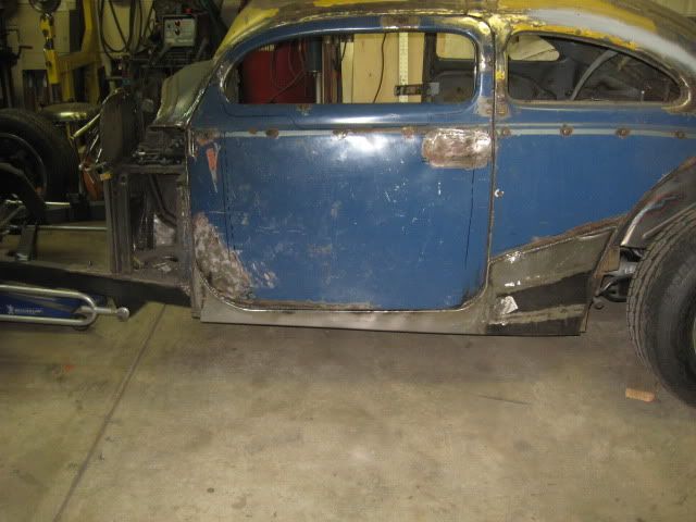

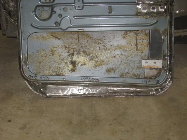

Well I kinda have an idea what I doing with the doors . After welding the botttom inner piece on the door , forgot about a threashold and carpet . So I cut it off and started over . Raised up 3/4" .
Now by splitting the door I can make it look flush on the inside.
I'm thinking of welding a heavier gauge steel in the front door jamb area . I 'll get to that later . I put a nice gash in my side lots of blood .. no stitches needed. Thanks to crazy glue . Burns only for a little while though it was relieved by a shot a Jack .

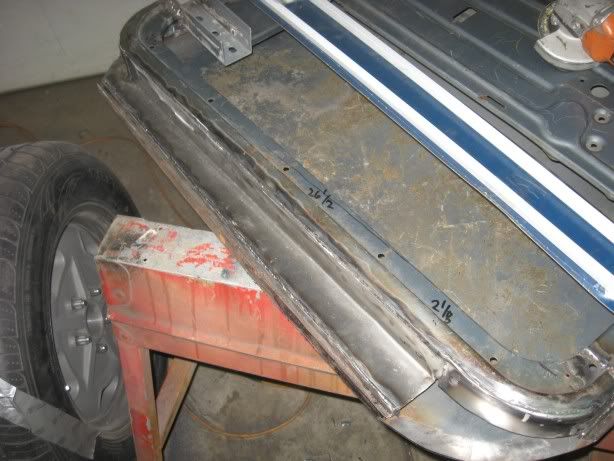

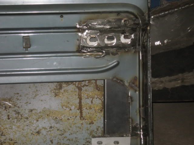

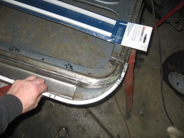

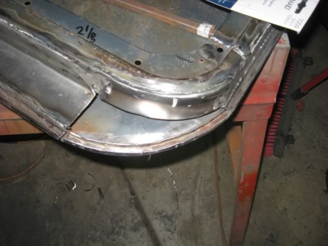

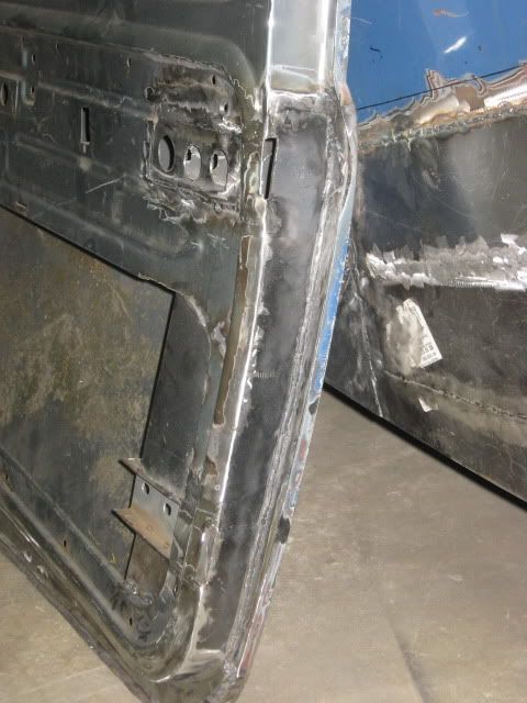

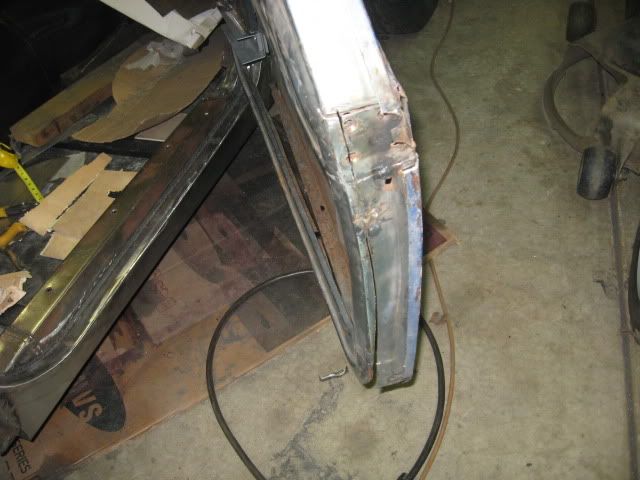

Finally some progress - I have one door fitted up . The suicide hinge works finally. Started to finish the inside of the door . It's more than I expected . I welded in some heavy gauge steel in the front for the bear claw latches. I plan on using the VW style door seals . Oh what fun.

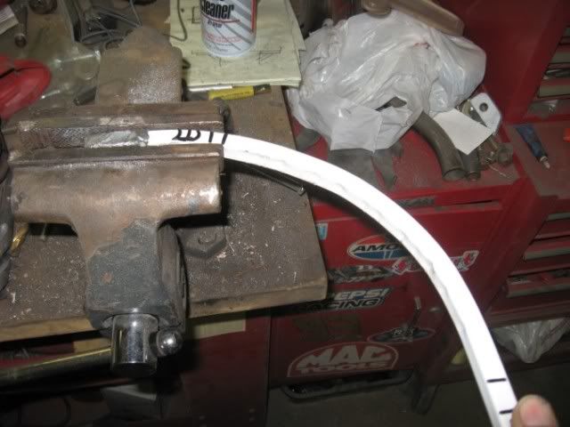

Nobody carries the thin gauge .049 1/2 square tubing. So in my search I came up with 1/2" square tubing used for shelf supports from Home Depot.
A little old Skool bending with the vise.
Open cut one end . There you have it a custom seal channel .
Lower step of the inner door panel.
I have two weeks off around Xmas . I should get both doors done.

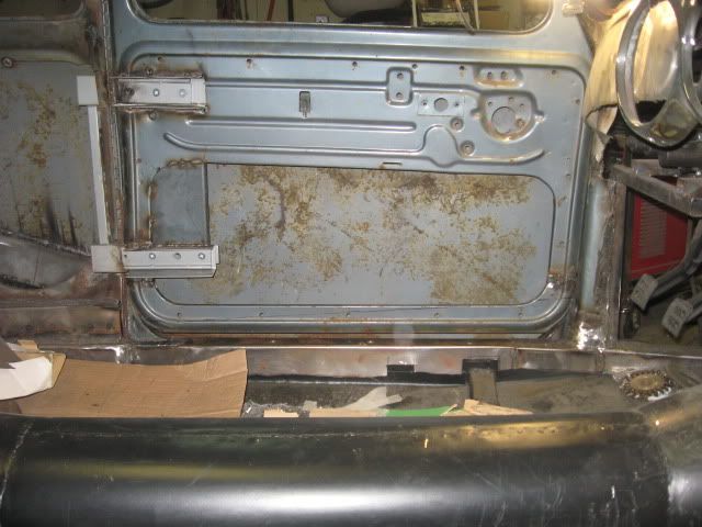

I did get something done . I was able to finish the passenger door . Looking at all the projects on this site with suicide doors and I have one question. Are you guys going to have windows that work? I had to modify my hinges to get more clearance in the door for the window tracks. I also finished the door so I can use a VW interior panel.

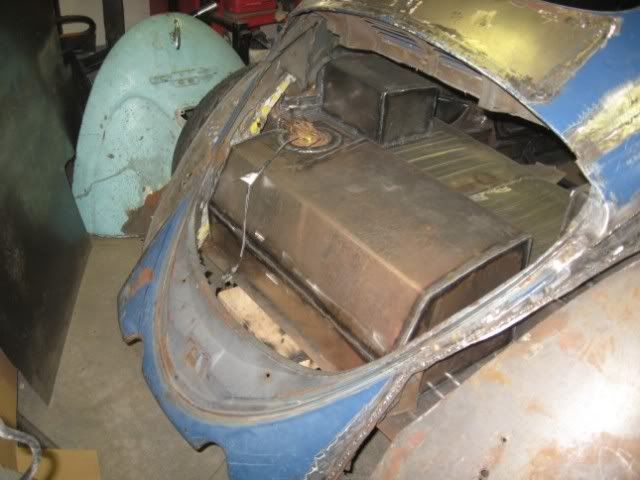

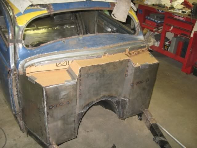

Trunk area
Foot box construction

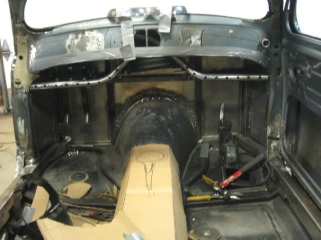

Mock up of dash

What is the idea behind the tall dash?

I have to hind the pedal brackets and the heater. I plan on add some addtional contour to it .

The dash mock up wasn't going anywhere. Someone rolled off an idea and I think it will work.

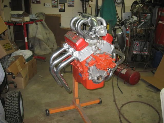

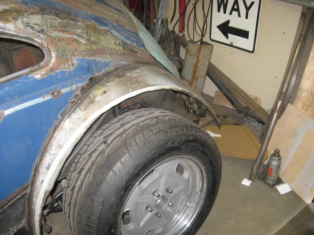

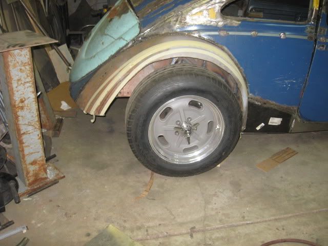

Finally got the new air plenum . It does look different. Then again there were some strange looking injection systems at the strip in the 60's. The color will be different on the block.

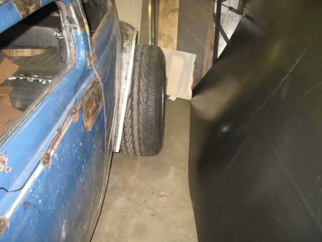

I do need your opinion . The rear fenders. What do you think?
Less tire exposed?
More tire exposed ?
I will roll the edges to finish them.

Are fenders required in your state? If not, I would go with out all together. That big fat tire looks great hanging out there. Project is looking killer. You have gotten a ton of work done!

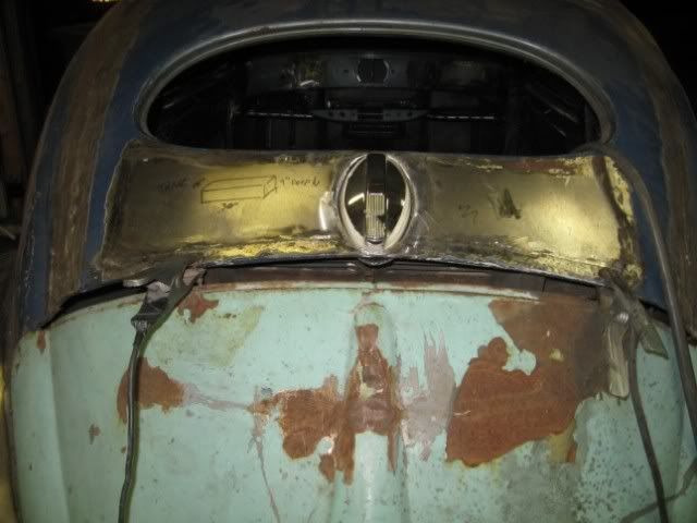

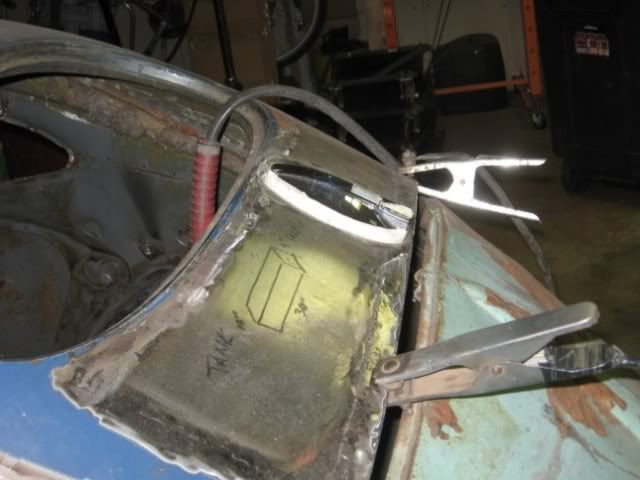

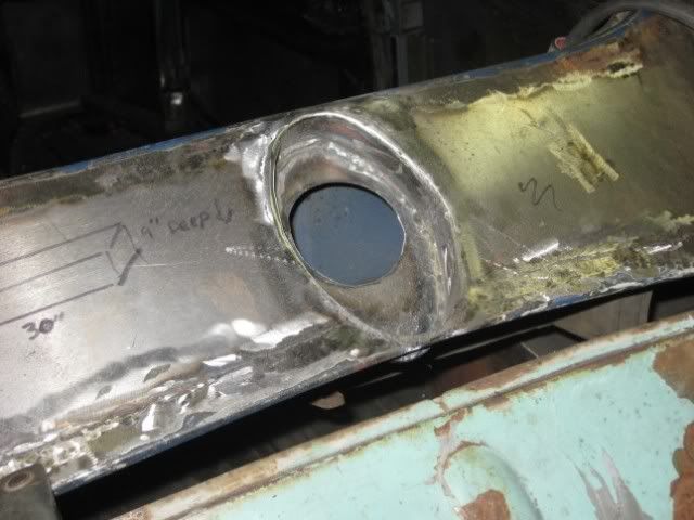

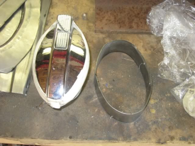

Since my gas tank is in the back .. I got a little creative with the tank filler.

Ditch the fenders amigo!
