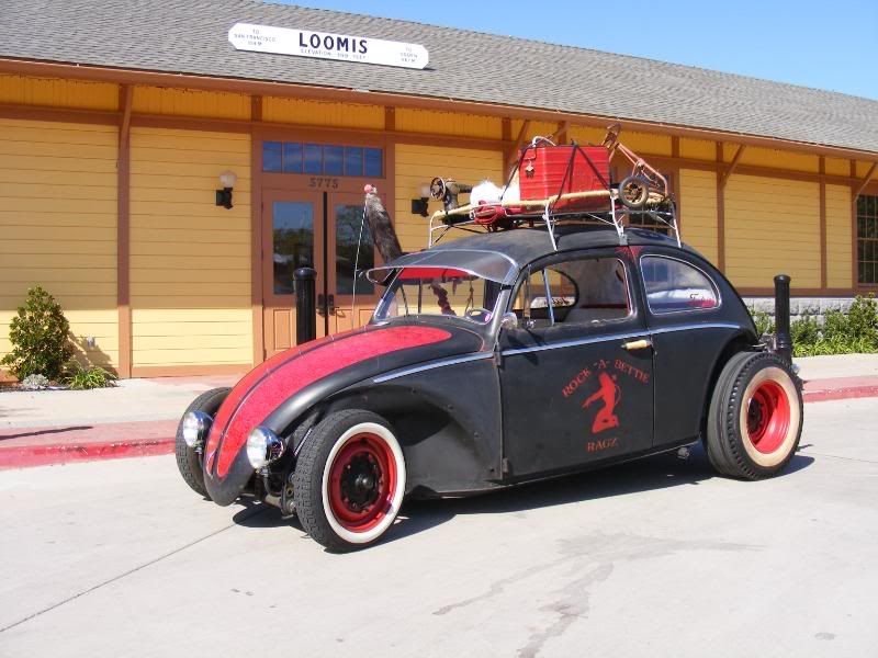

I was trying to stay away from the adj beam cause its pricey im going to be running some 265/70 tires in the back and 135 up front, No offense to rockabettieragz but i dont want mine to sit like this The car is awesome but i personally don't like how high it sits in the back. I want to keep it level and low(but not slammed) does anyone kn ow if the 265's will make it sit that high?
Any input on that would be much appreciated.
