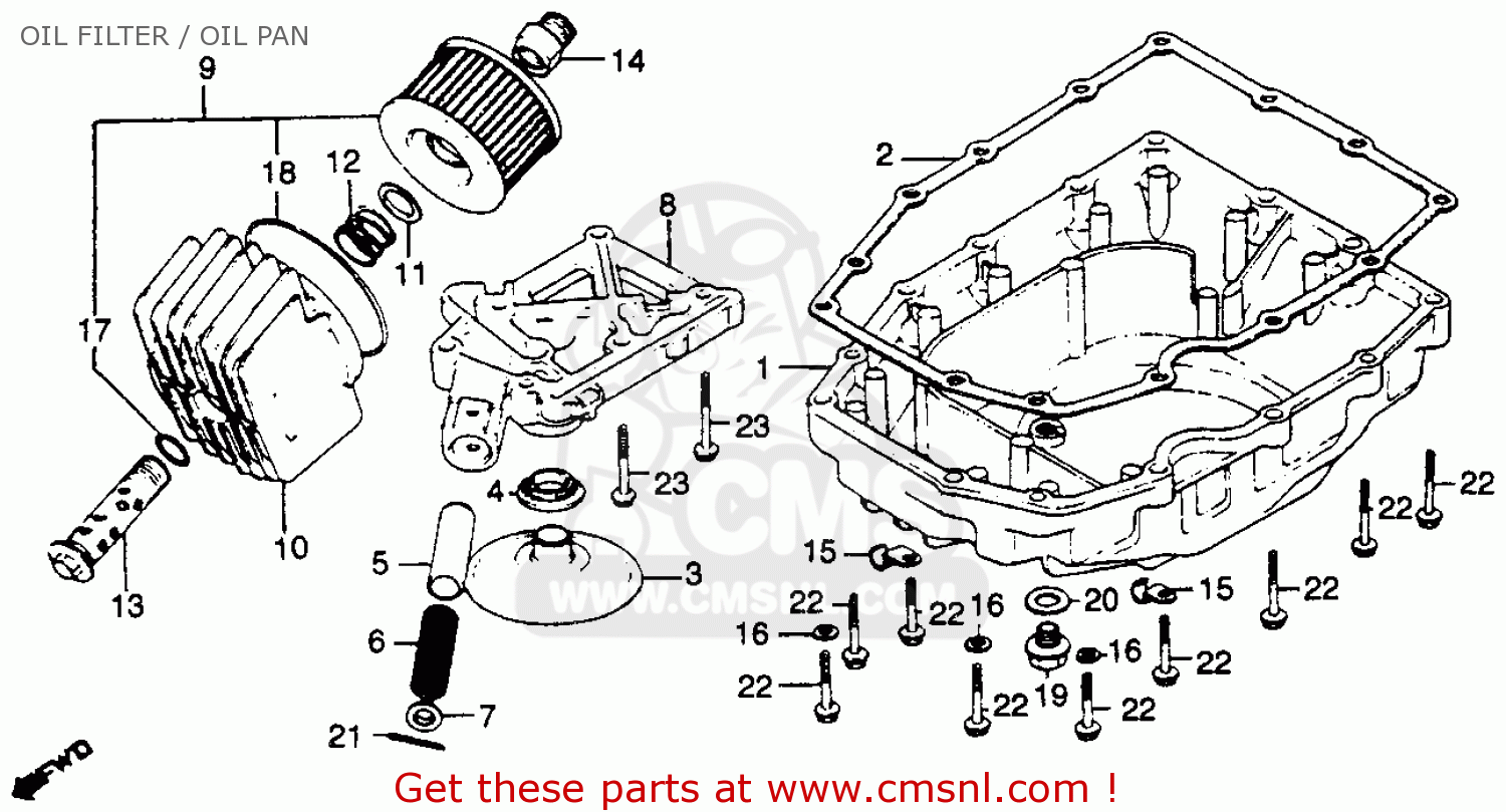

One major question... Is the oil filter cover held on with a bolt or a stud? The previous owner to the guy I'm getting it from welded the nut on. don't know why? Looks like I'll have to do some carefull grinding and then some Quality repair.
It's a bolt. God sakes get that thing fixed! If anyone has to weld on any piece of hardware that keeps oil in the engine... needs a slap in the face. Big no no.
The bolts are extremely cheap and very easy to find as most CB owners over torque them and strip 'em. I found a brand new one for $10. Best to get two just in case. Oh, and never forget the o-rings when replacing the filter.
An exploded view of the oil stuff. I linked it as the size is HUGE.
