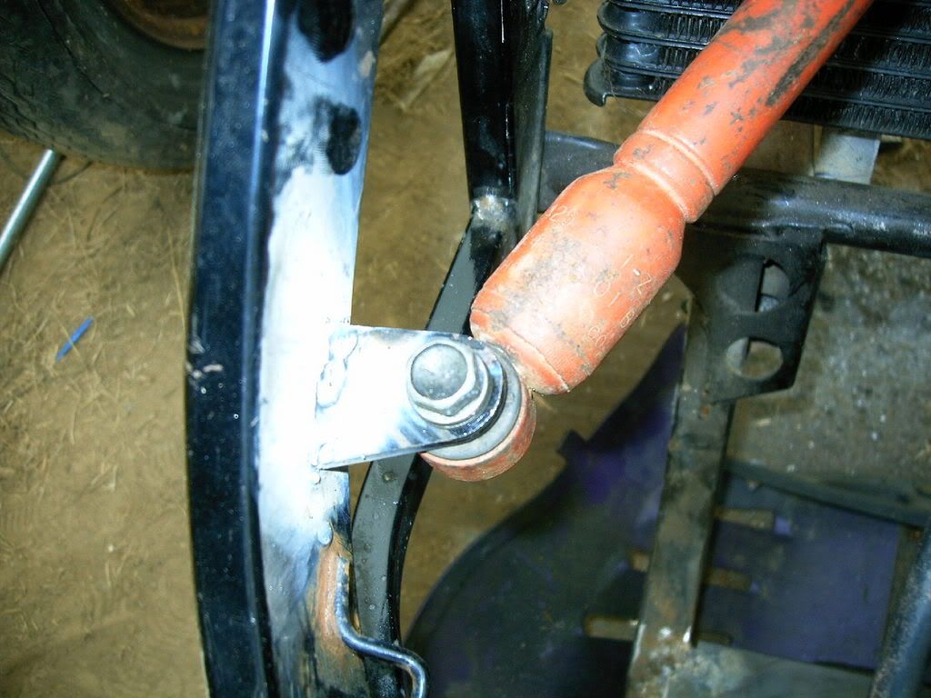

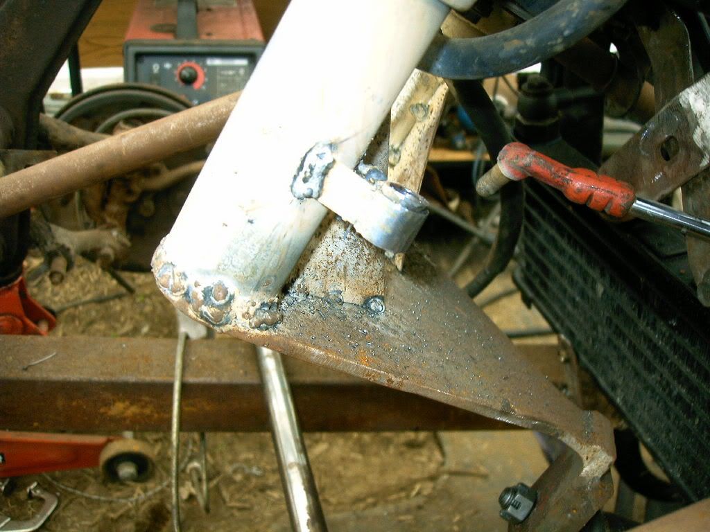

between yesterday and today i got a little done on the quad.
first order of business is the oil cooler mounts. i am using the original oil cooler from the 600 gsxr.
first pic. i took this random strap i had from a mower deck and cut them to this shape.
second pic. here they are welded into the frame. picture is looking up from under the quad.
third pic. so i had to make the upper mounts and what better to use than a bumper bracket? so i split it in half.
fourth pic shows the braces (the X) and the cooler in place after some grinding and bending

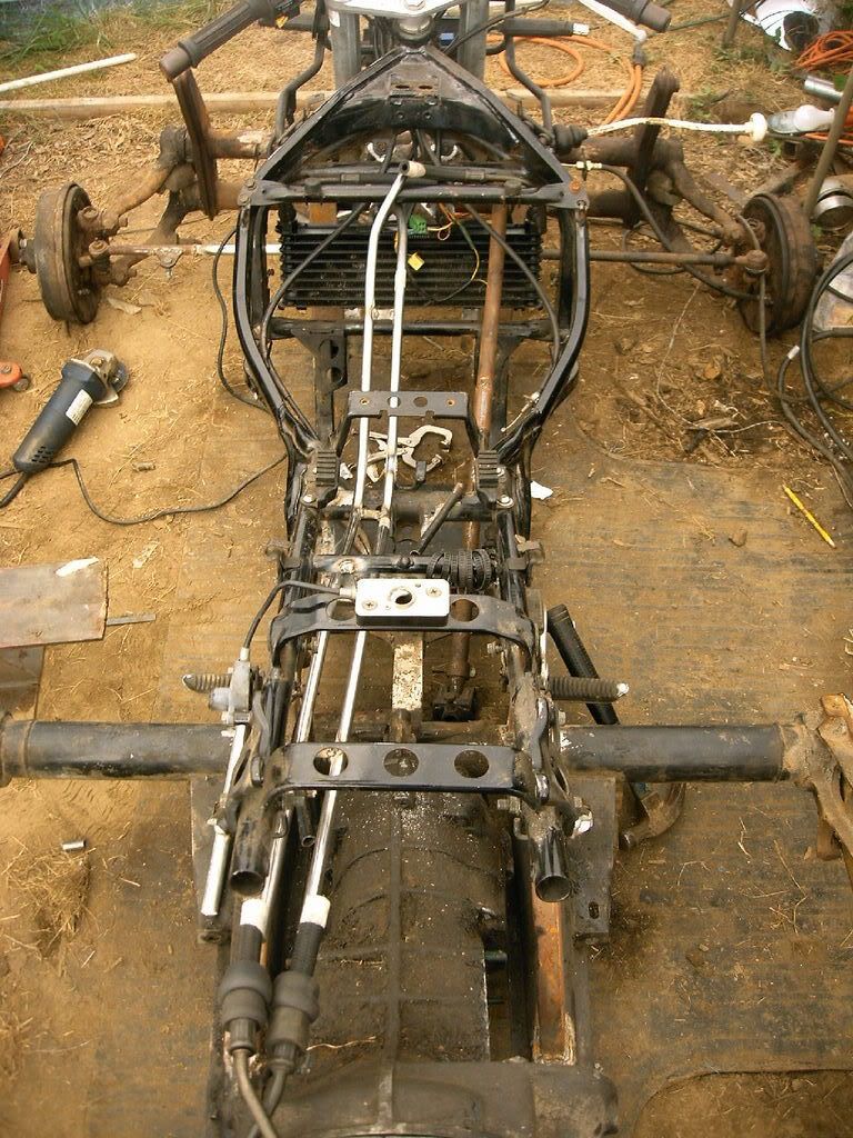

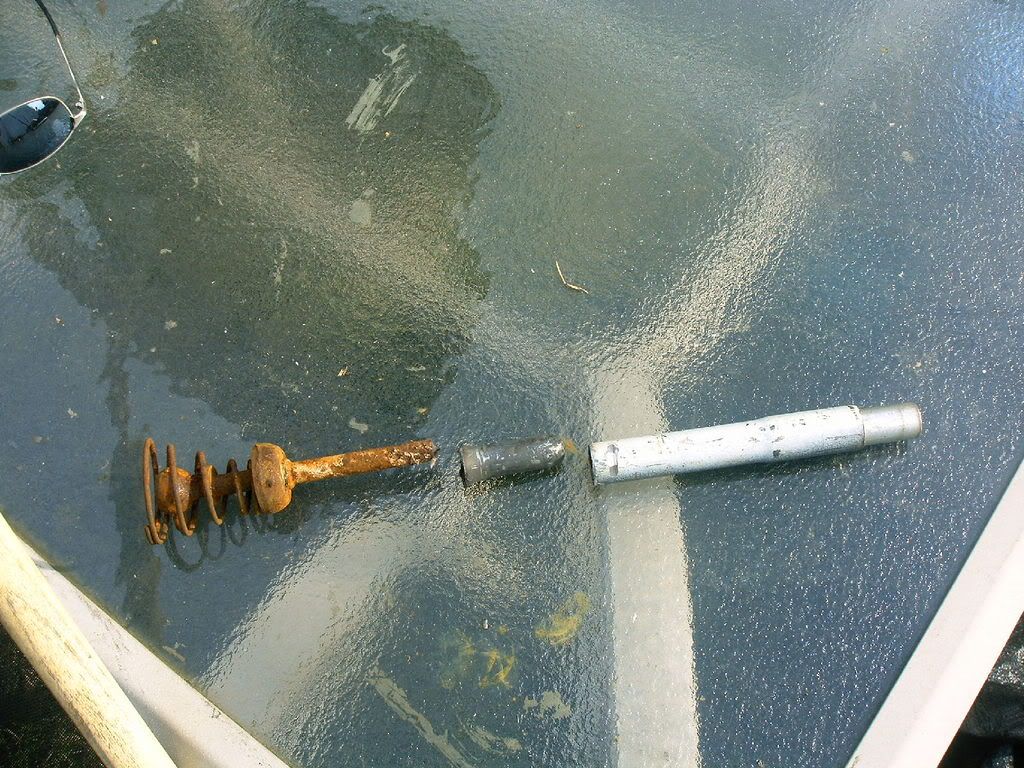

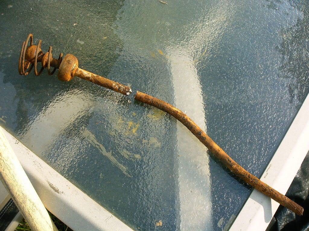

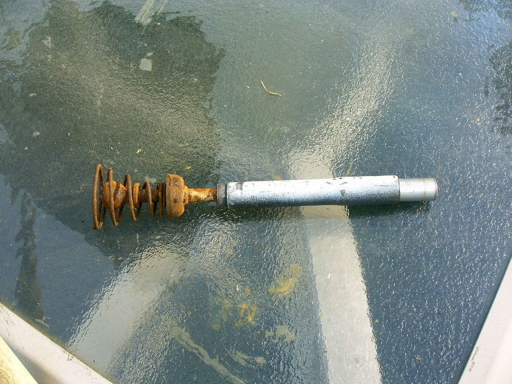

this morning i made my new shifter.
started out with this old rusty shifter
as you can see i cut it a few inches from the bottom. the shifter isnt very thick so to make it bigger i took a bicycle seat post and cut it. the end of it narrowed some so i cut that and made it a step from the larger seat tube down to the shifter. so here is all the pieces laid out.
and here they are test fited together
i did a little welding and here is the finished product. ill put a shift boot on it later to finish it up

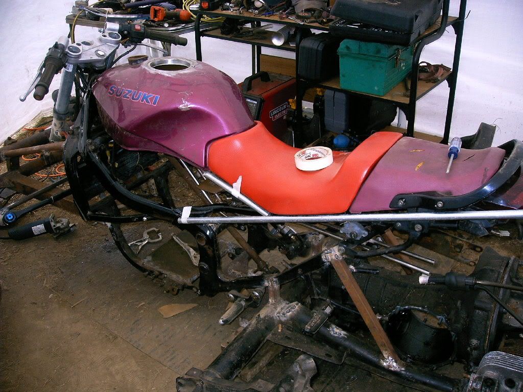

ok the other bit that i thought about today is finishing the frame. the katana normally is covered in plastic. i like the look of the streetfighter style motorcycles. the problem with this style and the katana is around the seats. the seat sits about 1 1/2" wider than the frame on each side. so this looks kinda stupid and i need to remedy it.
what this pic shows is how i am going to use conduit to bump out the frame. the conduit is not for structural use. but i can use it for making the frame look bigger than it is. i am going to do it in 2 pieces per side. the first one is going under the seats and attach to the frame about mid way. this is what you see in the pic. the second piece is taped on but represents what i plan. the second one will travel up and around the tank. once on these will be painted or line-x'ed or what ever.

Old November 24th, 2007, 02:40 PM   #42
Default Re: Volksquad
ok i couldnt help it.... i had to go out and mess with it until i could take a pic.
i didnt have a bender around so i pulled a gumpy (thanks bud!) and cut slits in it and then bent it. this will be fine for my application since these are not structure pieces and when the frame is covered you wont see any of it
i am using 3/4 inch for the bottom piece... bent in 3 places. i tacked it on in one spot but i will need to make a few braces tomorrow
the top piece you can see took a bit more
from this angle you can see all the turns that twist and turn around the tank.
