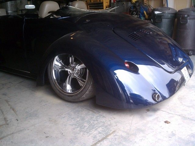

Poor lighting but here's a door panel. One down, one to go. The "tan" color is a tad off from the seats but I'll (at a later time) color match everything! I have a plan...
The swooping "V" raised panel will carry in to the front quarter panels and around the B-pillars. Should have all the panels done this weekend. Hopefully the new carpet comes in today?
Anyone notice the late style window crank? Yep! The regulator in the convertible door is out of a '67 Sedan.

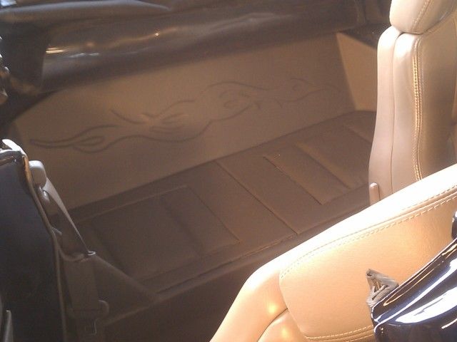

Interior:
Carried the swoopping V through the kick panels.
Luggage area behind the seats. You can also see the B-pillars are completely wrapped and the seat belts are in:
On the back panel, it's a raised tribal flame design. For fun, I also replicated the front seat panel design atop the access doors.
