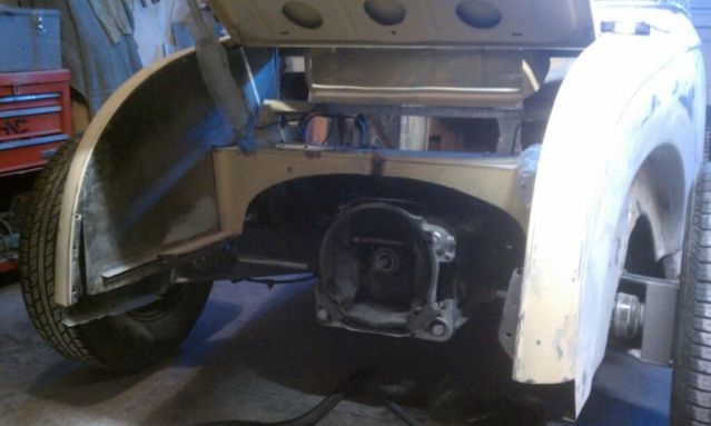

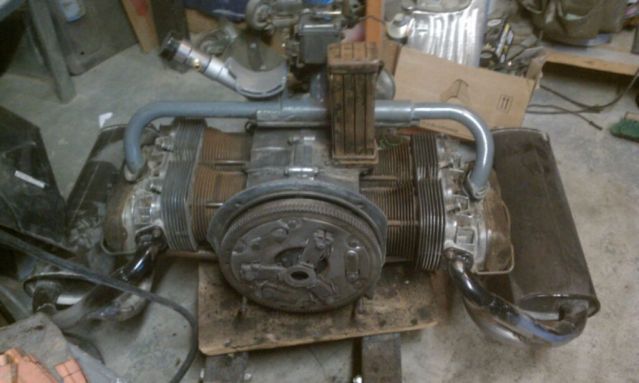

Ok, so pulled the motor out and yanked off the tins for cleaning and detailing. The shroud had a couple of holes so filled them in and sanded it down.
There is a push rod tube pretty dented so I'll pull the heads and swap those for fun. Also got a new clutch plate installed. The plan is to color match all the tins so not much chrome on this one.

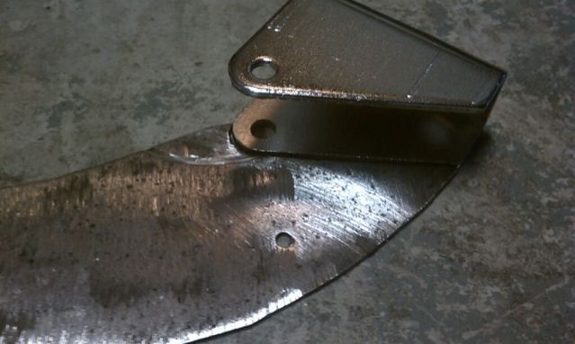

With the motor out, I got to work on relocating the actuators to the top of the shock towers.
motor out:

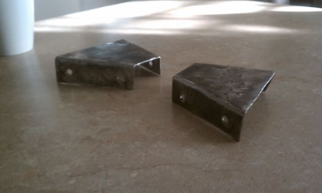

Because I don't have clearance to drill in to the cross brace, I bent up some brackets to mount the bracket.
When I was doing a rough guess on the further back actuator location, I guesstimated on the length and general shape of the deck/trunk lid mounts.
Feeling confident, I cut out 4 new plates:
Using the original mount, I fitted a side up:
Completely wrong. So cut them apart and reposition:
Now my starting point was with the actuator fully retracted and the trunk lid closed. To the left of the bracket you see two black pen marks. This is where the bracket "should" go. With the actuator fully extended, this is where the brackets end up. Oops!
The limitation is the actuator arm hits the edge of the trunk lid being higher up and at such an angle that the bracket will not go on those two black marks.
Four hours shot.
My choices are to leave them in their current working location OR re-take Geometry or some form of mechanical engineering. The current location looks great...that was a dumb idea MUNDO!

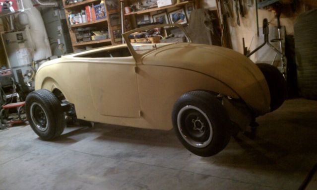

With the motor out, I've also been working on the rear cooling seal that wraps up and around. Been bending metal tracks that will be added here shortly.

Well, didn't give up on the repositioned actuator. Tried a number of things and still couldn't get it to work so...went on with bodywork. Got another quick coat of primer shot. Everything is still a little wet but at least now I can start looking for spots I missed or waves or whatever...

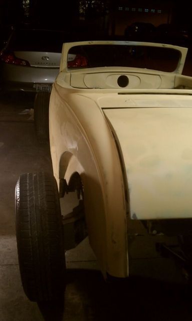

All this sanding is starting to pay off. The fan shroud in the back had some holes filled and also a shot of primer.
The front quarter panels turned out better than expected.
There are a million little detailed spots that need a quick sand or more attention. Those will get worked out over the next couple of weeks.

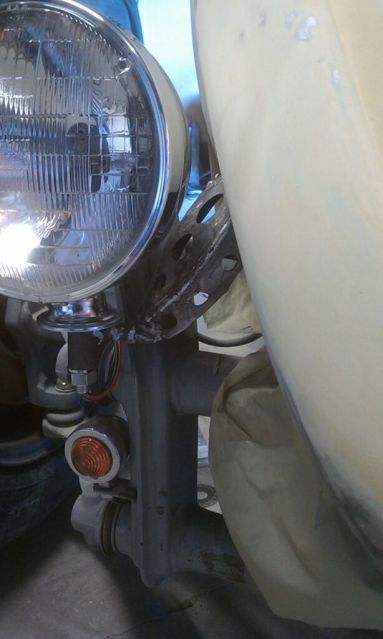

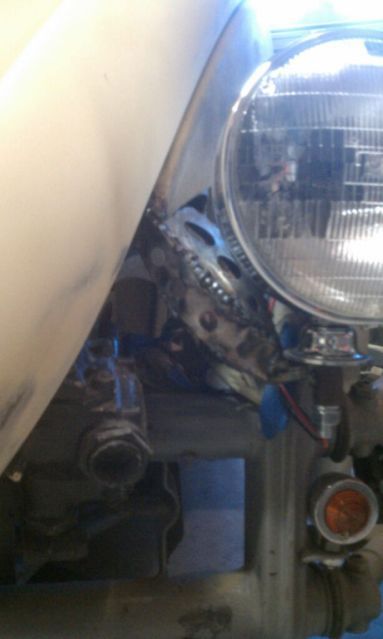

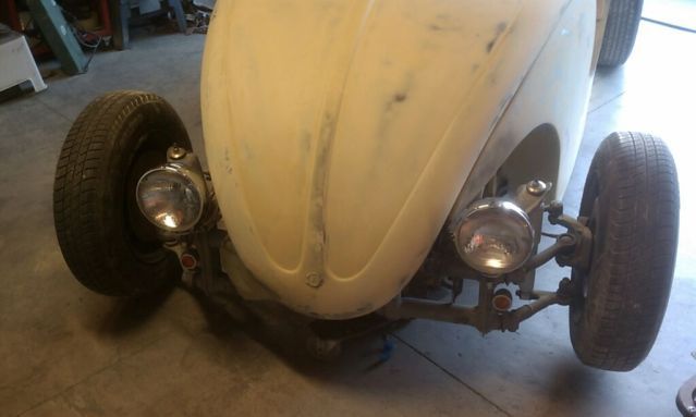

Taking a break from block sanding, turned attention to the headlight mounts. Wasn't real happy with the previous mounts, so made a couple mounts that attach permanently to the body.
Lots of grinding work to go.
Not sure what went wrong, but after measuring a dozen times in different directions and duplicate patterns of the one completed side, one side is off. With everything in the "proper" place, the passenger side headlight is a shy under a 1/2" closer to the hood. Same height at the mount, same spacing between the shock towers, the passenger side was just a 1/2" too close to the quarter panel. Oh well, close enough. At least the height matches!

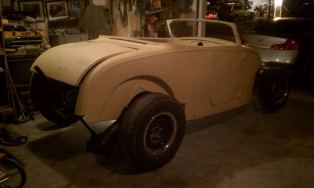

There has been progress in bodywork since last post. Nothing exciting. Before leaving for a three week family vacation I was working on the upper driver side door hinge pin. Well, it broke in half inside the hinge so smashed the hinge with a big hammer.
Now I'm needing an upper door hinge.
Got the front headlight mounts smoothed out and shot in high-build:
Also got around to making a battery box:
It attaches to the cross brace so when I get to wiring, I can find a sweet spot and screw it to it.
Got the dash all shaped and the underside transition all smoothed out.
This is where I left off for the weekend. One more good session of block sanding and it will be ready for paint.

Also pulled out the old motor and found a really great deal on a newer 1600DP which I couldn't leave alone so dressed it up.
Old:
Dressed up new:
Mundo came over last weekend and helped me get it stabbed back in. Hooked up all the stuff and had distributor issues. Working to make it run.
