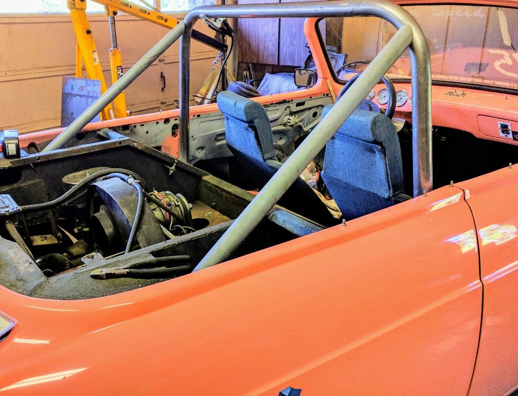

Got the last of the sticks for the door bars and the shoulder belts/seat bars and need to get a tubing notcher. anyone here used a harbor freight unit?
65 Sunroof Notchback
Old June 27th, 2018, 08:02 PM   #30
Posts: 3,616
Default Re: It's really happening...
I used one to notch the ends of one piece of 0.090" wall 1-1/2" tube back in 1997, it seemed to work ok, I used a 6 flute end mill on a Bridgeport mill, it wasn't my tube notcher but it was bought at H/F, I worked with the guy who's it was, he used it on a bench mount drill press using a hole saw, he went thru a few of them things but I think he was just feeding it down to fast because they kept grabbing and chipping teeth off, I wasn't there when he was doing it, he didn't have any machining experience, he was a welder

so, put it on my press on the slowest speed possible, use lots of oil and pray?

And use light pressure feeding it down and you should be good, bolt everything good and tight as well

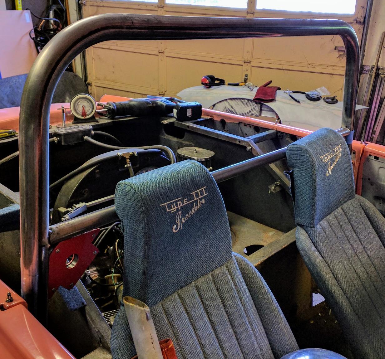

Found a tubing notcher to borrow. Now the shoulder belt bar is tacked in.
Looks like I will have to build a new seat mount. I bent one apparently...

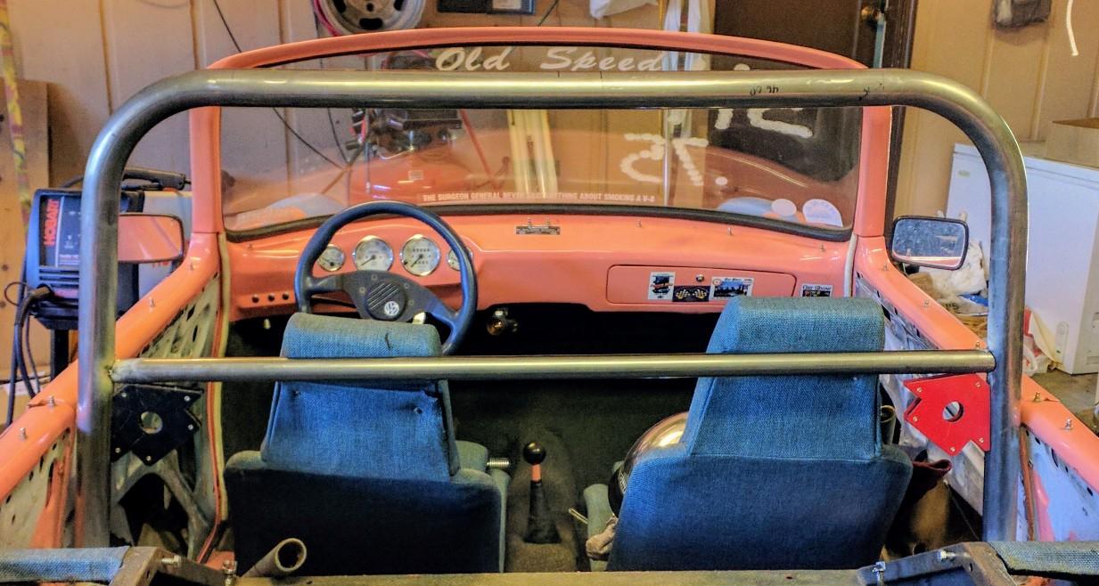

Is that shoulder bar too high ?
Check the NHRA spec on shoulder belts.
IIRC, should be lower than the top of your shoulder, so the belts work properly.
Old July 10th, 2018, 12:04 AM   #36
Posts: 6,478
It actually is below my shoulder. 914 seats cause this illusion. Look atpost 21

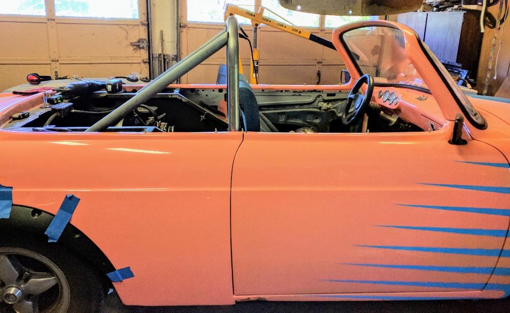

Alright, all the stuff I could do for zero $ is done for now. Both sides cut, slicks mounted, racing hoop and support bars mocked into place.
Next up is to find a welder that can see and lay quality welds.

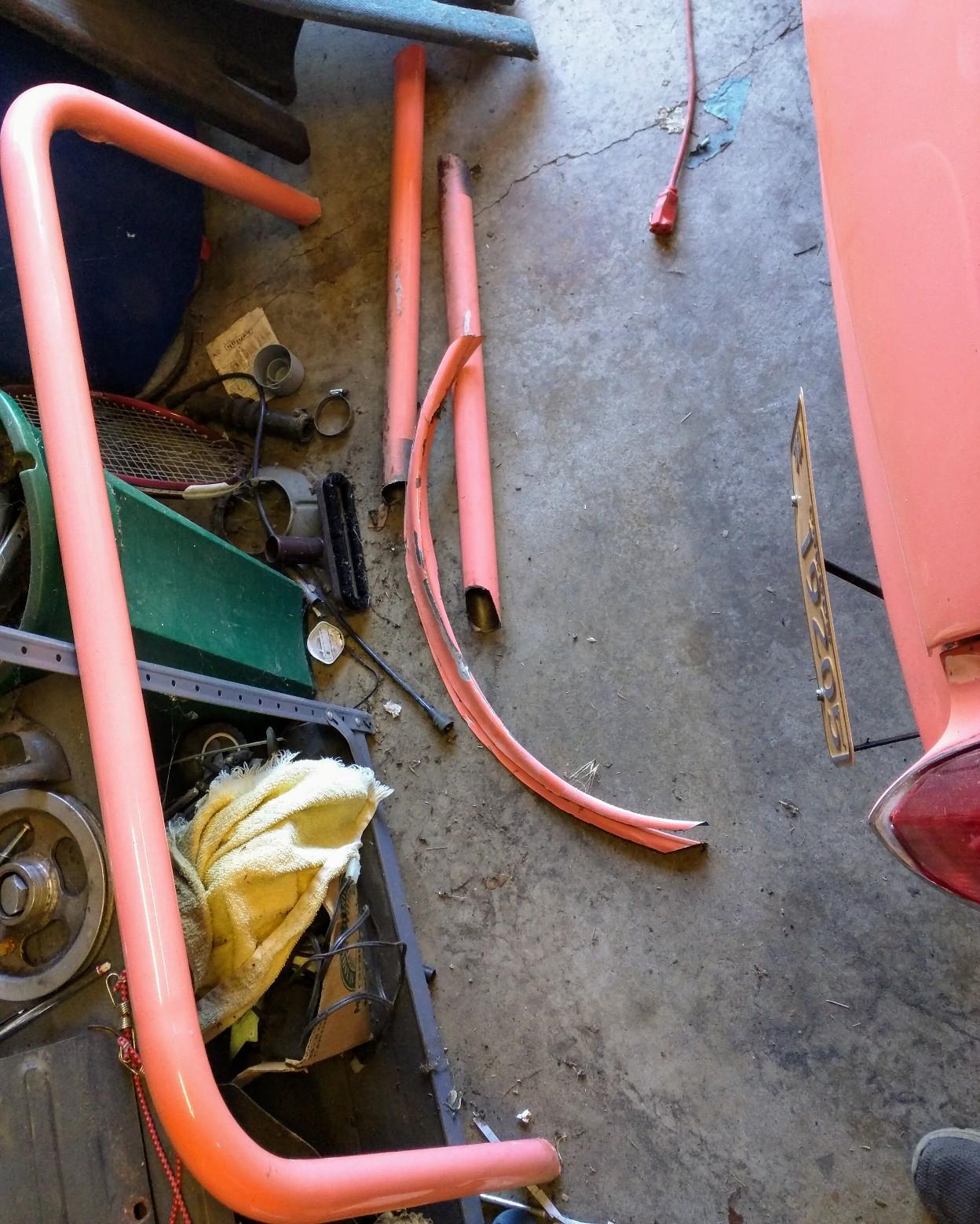

Oh, out with the old...

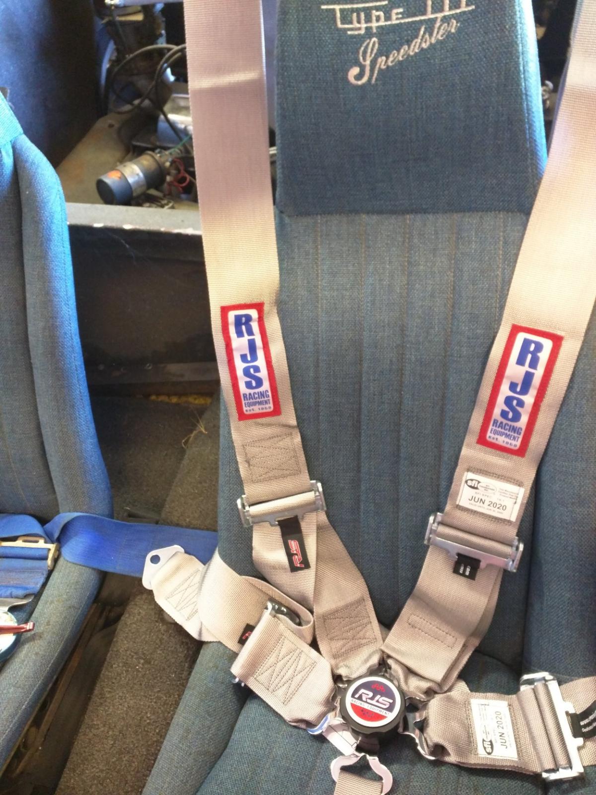

Very nice new belts! Thanks to Mike Greenway! My first ever parts sponsor!!!!
My club sponsor is VR. I will be wearing my plaque proudly when this thing is done!
