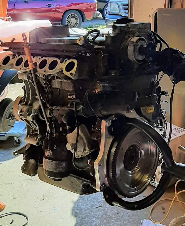

I have been inspired to try something totally different... even for a mid-engine notchback owner.
I have hardware coming to adapt a VR6 to my car. Going to go turbo, mild boost and hopefully have a track friendly ride that will also be street useable for weekend cruises.
I have the turbo exhaust manifold, alum adapter for the engine to trans, flywheel and am currently working on a short runner intake manifold.
This will either work or fail spectacularly!

Progress. Got the KEP adaptor installed.
65 Sunroof Notchback
Old September 6th, 2019, 10:41 PM   #99
Posts: 6,478
Default Re: It's really happening...
Going to measure vs the current hole to see what mods are needed. Flywheel for the swap is installed.
