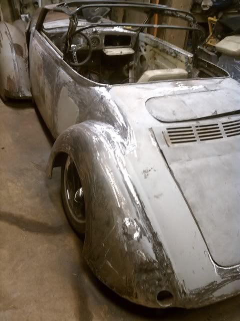

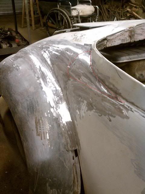

By the way Fernon, got the upper quarter panel piece added. A slightly bigger piece than you showed in black, but it does the trick for the body line transition up and over the top (there's a very slight red line I drew in over the section I welded in.)
From the rear:
It's hard to tell, but it flows just right.
Now it's time to go focus on the front edge of the rear fenders and get them molded/completed. Can only do so much at a time.

You are really pulling this off to the point that I see this car being an historic Volksrod in the future. Your build is turning into a work of art. Outstanding.

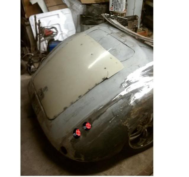

Still raking my brain on which direction to go with tail lights. Now that I'm re-working on re-doing the new rear decklid, I've once again began thinking about the tail light situation.
Opinions or thoughts about frenching two 2-1/2" or 3" rounds just above the round exhaust ports?
Fernon...if you're out there... you said you had a source for flush mounted round lights? I could do LEDs?
I know I keep coming back to the tail lights but I don't want them to be an afterthought.

MarkH, I was wondering when you were going to give into the frenched tail light idea (LOL).
Here are some trailer lights that are priced right, sealed and that are 3-function, plus they have a very shallow profile.
10 LED
http://www.etrailer.com/Trailer-Ligh...s/STL43RB.html
12 LED
http://www.etrailer.com/Trailer-Ligh...STL23R24B.html
These guys carry quite a few tail light options for street rods.
http://www.streetrodhq.com/shop/sear...skip=80&Max=40
These are a little pricy but they have the back-up lights built-in.
http://www.uatparts.com/miva/merchan...ory_Code=MAXX2
you did a great job on the body, I'm just not loving those frenched lights. I've seen to many VW's with glass fenders with that look. How about something low along the bottom edge? Ore the old standby pontiac glass rounds..

I think some surface mount longer thin lights that moutn on the peak of the rear fenders would look good. Something sort of like 41 Studebaker, but those are kind of overdone and unoriginal, but still hard to find a good pair for reasonable price. The 40 Ford chevron look tailights could work, although also a bit popular. 49-51 Merc style tailight is horizontal and would have to wrap pretty low around the bottom of the fender, if the curve is even correct? If you have a good swap meet around, just look at what people have and something may jump out and be the one to use. Take some cardboard templates of the fender curvature and see what you find and what may fit good.

You are killing me with this build, love it!!! How about flush mounting new beetle tail lights, smoke colored after market style. Big round light over little round exhaust port. What ever you do, I'm sure will be killer....

Thanks for the input guys. Norville, been thinking about the lower strip light as you shown however for driveability, I believe the tail lights need to be at a certain height? Could be wrong but leaning towards something mounted a little higher.
Bullet style tail lights have crossed my mind as well as vertically mounting caddy tail lights up the fender line. Even considered the round Pontiacs. Ford Chevrons.?? Hmmm...
We have the big Portland Swap meet coming up this weekend and I hope to find something that will really click.
Frenched tail lights are probably overdone... but I'm liking the repetition in line with the exhaust ports.
Spent countless hours looking at various tail light options. Driving me nuts. I'm going to need some serious therapy if I don't decide soon.

Looks like Unkl Ian wins a prize!
Went with '56 Chevy LED bullet taillights. Had to french them but they turned out. Updating build thread with how I frenched them. Almost a step by step.
