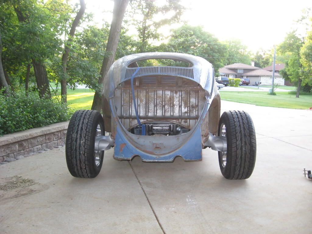

I need you opinion. I like the flat finish look with a lot less gap between the inner rear fender and the inside wall of the tire . So the rear apron is style is the ????
Now Don't laugh at the next few shots
Yes It's Duct tape
What do you think?
I'll need to dust off the old "E" wheel to get the panel to roll just right.
The other option is to scavenge a few old rear fenders and cut them to fit .

Hey Joe, the nose looks good.
I would use the E wheel. Whats your plan for the top of the wheel opening(where the old fender bolts to the qp and transitions to the piece you're going to make)?

I like the model A panel idea and where you are going with the duct tape.
How about making a body line bead that starts at the leading edge of were the body and rear fender mate...that goes up and over the wheel well and then goes across the bottom of the apron to the other side.
Kinda like a 32 ford without the two body lines that come down the top of the quarters. Just the fender bead and the bottom bead.

Duct tape - the greatest material around beside WD40 . Just using the tape to get a visual reference of the body transitions. It makes it easy to lay construction paper on to make a template.

I looked at it some more.
I think the shape of the flat panel needs to change. Instead of being a semi-circle, it needs to be more teardrop shaped. Material needs to be added to the back rearward side of the panel to make it swoop back and more closely follow the rear shape of the bug. .....stretch it maybe 6-8 inches at the very bottom.

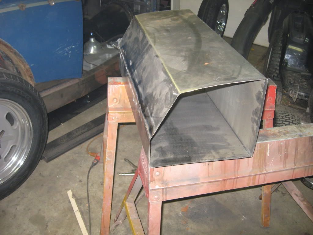

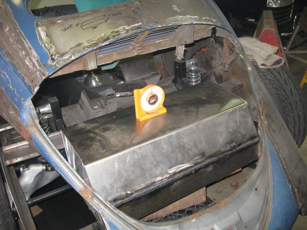

Gas tank ... yes it was one of those things that we need . I try all sort of configurations and finally came up with this one
I was thinking of covering it with some leather like fabric to make it look like an old trunk case w belts. I'll get that ??? hey where the gas tank? What gas tank!
More to come soon.

It's funny how I'm starting to run out of room on this project. Gas tank & battery have been a challenge .
