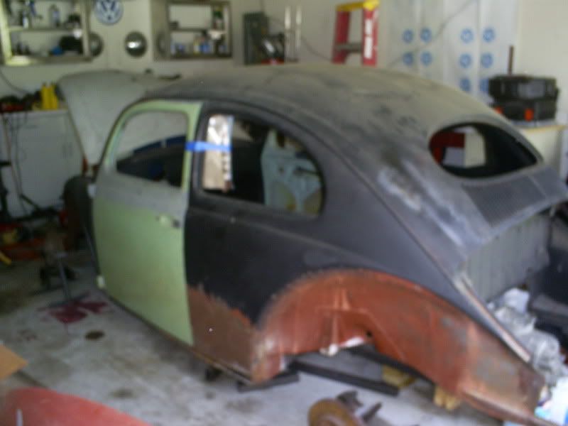

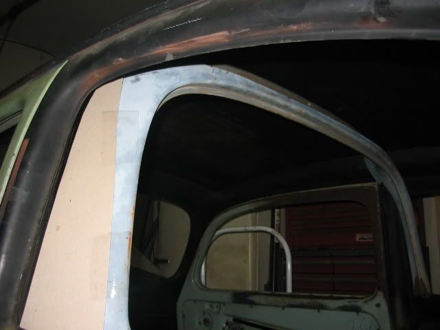

Did some test fitting to see if this idea is going to work. I'm mounting the frame with the "inside" still in the inside. I'll make filler panels for the sides and a flanged flat bottom for the seal.
This picture is through the front windshield,
Inside corner detail. I want to finish this out to look kinda factory so a head liner will fit in like the stock one does at the windshield.
From outside the quarter window. I think if I paint this side matt black it will tone this back a little.

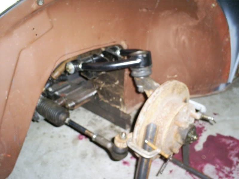

Now to start mocking up the upper control arm mounts. I need to trim out some space for the upper control arm. I want to add the rolled edge in the fender well like the original body work.

I just cut the fender well for upper control arm clearance. I left it about 1/4" long and then rolled it to make a nice4 clean edge. I don't know if the pictures will be any good but here's what it looks like. I have some clean-up to do on the edge.

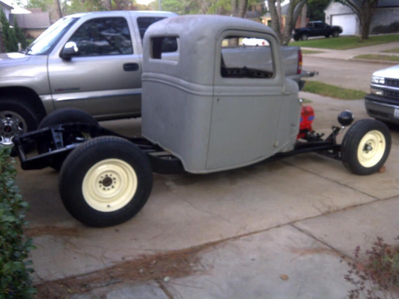

We now have a rolling chassis and should be firing it up in the next month or so.

Man I have been gone a long time. My last post was Dec 2012! Well, we got the truck running and licensed just in time to make this year's Lone Star Round Up. We had a blast and drove it from Houston to Austin and back with no problems at all. My son is having a blast and planning the next items to tackle on the truck so I want to get back on my '54. I have to go get it out of my shed on my property.
