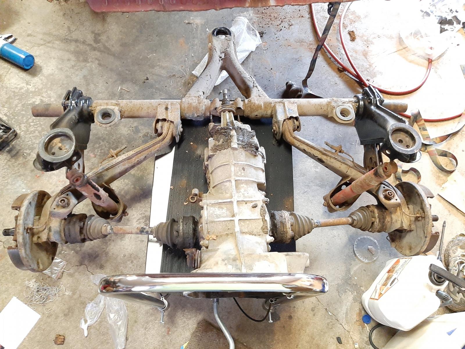

My goal was to have my subframe together, before New Years... 14 minutes to spare! Nothing is torqued, tightened or cleaned up, but it is installed!

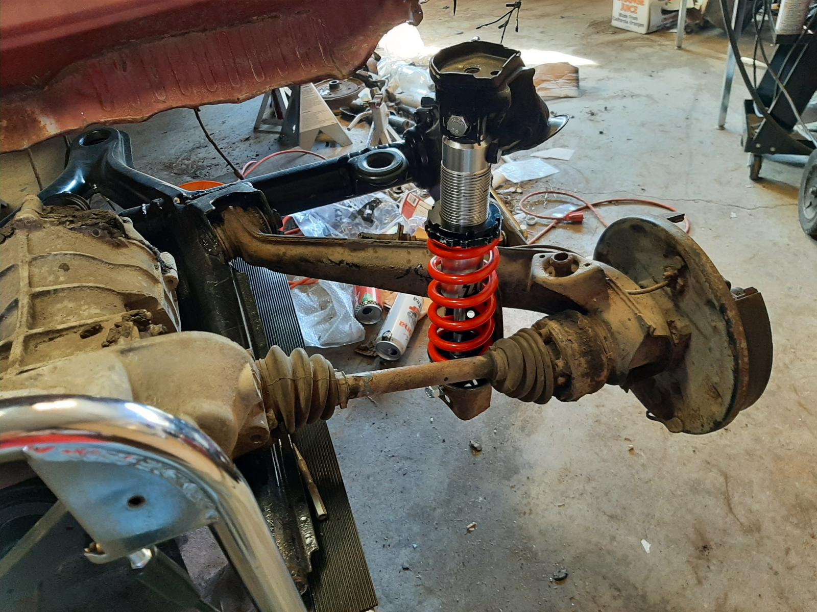

So, my shocks didnt fit the lower shock mounts... panic! After hours of complicated or expensive or both solutions... doh!!! Raise the bolt holes in the mounts. Doh! Doh! Doh! That with shorter springs should let my rear ride height as wanted.

Did you know that a t3 IRS transmission does NOT have mount holes in it to mount it to frame horns?
I do now! Doh!!!

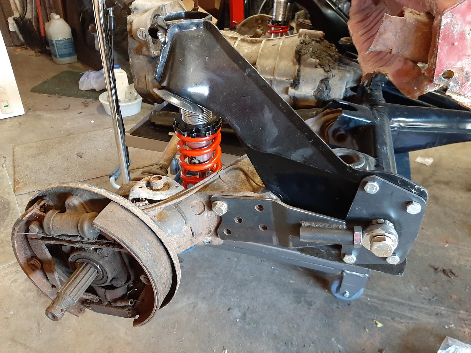

Default Re: The Roach

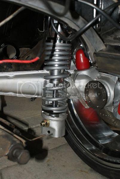

While trying to leave as much material as possible vs the picture above of an aftermarket unit, after an hour of careful cutting, i finally have a coilover shock in place. Now to match it on the otherside. Progress... sort of.
After spending time at a buddy's place with his skill on the lathe, my new smaller coil springs fit the end caps on the shocks. So, they went onto the assembly and everything clears! Tomorrow I hope to have the transmission mounts, well... mounted to the bellhousing.
Nice. Having the shock mounted that way makes for quick adjustments at the track.

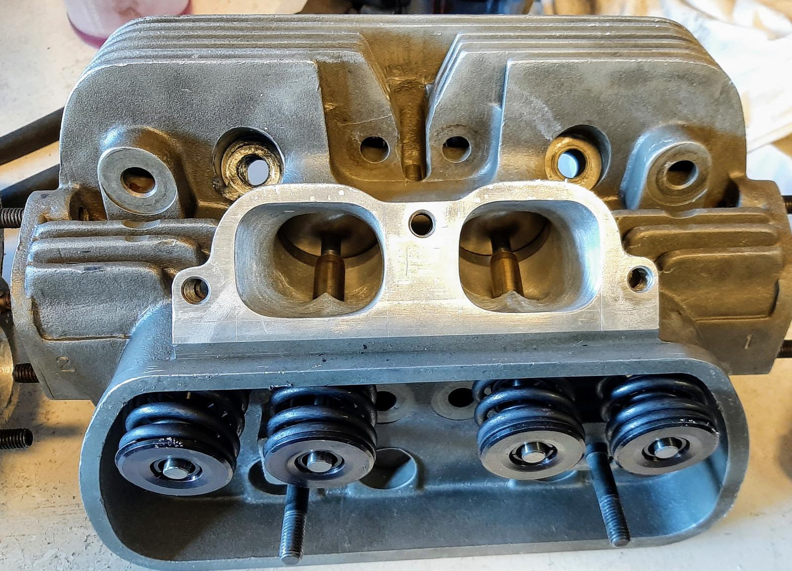

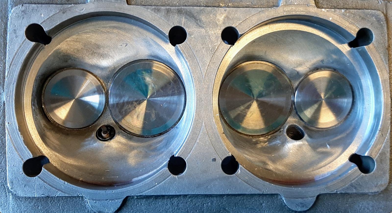

I finally got my new valves and support parts installed in my heads. 48x38 should allow some air movement.

Same size valves I ran in my Autocraft heads. The ports look much nicer than mine did.

Full cosworth style and bigger than the cnc version. I hope it isn't too lazy down low.
