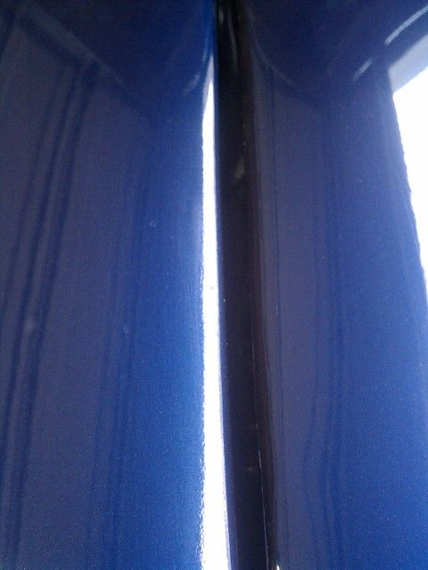

Ok for you paint gurus.
Already ran this one by Spencer (OB Customs) and he is as equally puzzled by what's happening to my paint. Ok a little overstatement there, I should say this one little area. This is the top edge of the rear decklid. Below is in the engine compartment, slightly in front of the fan shroud.
Here is a super close up when the car is cool and just sitting there:
Nothing unusual right?
Now go drive it for a little and let the motor warm up. Turn it off...
Freakin bubble in the paint. But this is where it gets weird....
Let it cool off again:
Bubble goes away!! WHAT!?!!??
I will say that at just the right angle in the perfect light, if you look REALLY hard, you can see just a slight residual ring of where the bubble was. Yes, I photographed the same area of where the bubble appeared. In fact in the after cooling photo, I cannot tell you exactly where the bubble appears.
Go drive it again....bubble comes back. This certainly cannot be good.
What's going on?
Spencer and I discussed what needs to be done in order to fix it (which involves digging down through this area and starting over, respray and clear) that's not the issue under debate.
What I'm curious about is what is happening in this exact area?
Ideas?

If you wet sanded the car and used any filler there is always a micro chance that a small bit of moisture found it's way into a tiny pocket (think hair width) and expands just enough when heated.

my first thought was water. I had the same problem with the Buick I painted. The bubbles on mine wern't that big but are all over the car. I only found them after I started buffing it, they showed up and looked like dirt, so I started sanding the dirt out and went to metal. Mine was narrowed down to water in the air line, that looks more like a hairline crack

Can you get to the underside and try to insulate it to see if it stops?

Since repainting is not the issue, just curiosity, use a very sharp needle, when it appears again, poke it close to the edge at a sharp angle to the center, roll your finger over it to the hole and see what comes out. Heat is the activator of course, but it could also be something as an air bubble in between the layers of paint at the surface, (if there is no bondo here). Usually a bubble in bondo, or some chemical contaminate got on the surface, water, someone's sweat droplet, even the beginning of a new rust spot not seen the first time around. I've seen it happen before from just the heat of the day.
Insulating it underneath may stop it, but I bet if you park it in the sun on a really hot day, it's gonna show up again.
But no matter what, to fix it right, strip and repaint the area.

Strip it down and restore to stock...that's funny right thar!
There is a little room to insulate but I'm afraid that won't keep the zit spot from coming back on a hot summer day.
The forecast is for two really nice days this weekend. The car will be drivenfor sure but I'll find some time to stick a needle in it. Just for fun and out of curiosity. Re-painting the rear deck is inevitable. Kinda sucks.

it can only be two things,contamination when it was sprayed or a small pinhole inside the bondo. My guess would also be water contamination. Painting can be so rewarding or so very frustrating.

hey markh , havenv't been on here in a min. you know life, i myself am a automotive painter and had that exect problem with a hood on a chevy truck i painted, it turned out the customer did the body work on the hood and did it right , but let it sit bare filler and hummity is were the moister got in, we were told in a ppg class to always put a heat lamp on body work that has sat over night. and before spraying primer if it has rained been cold or high hummity . hope this helps
